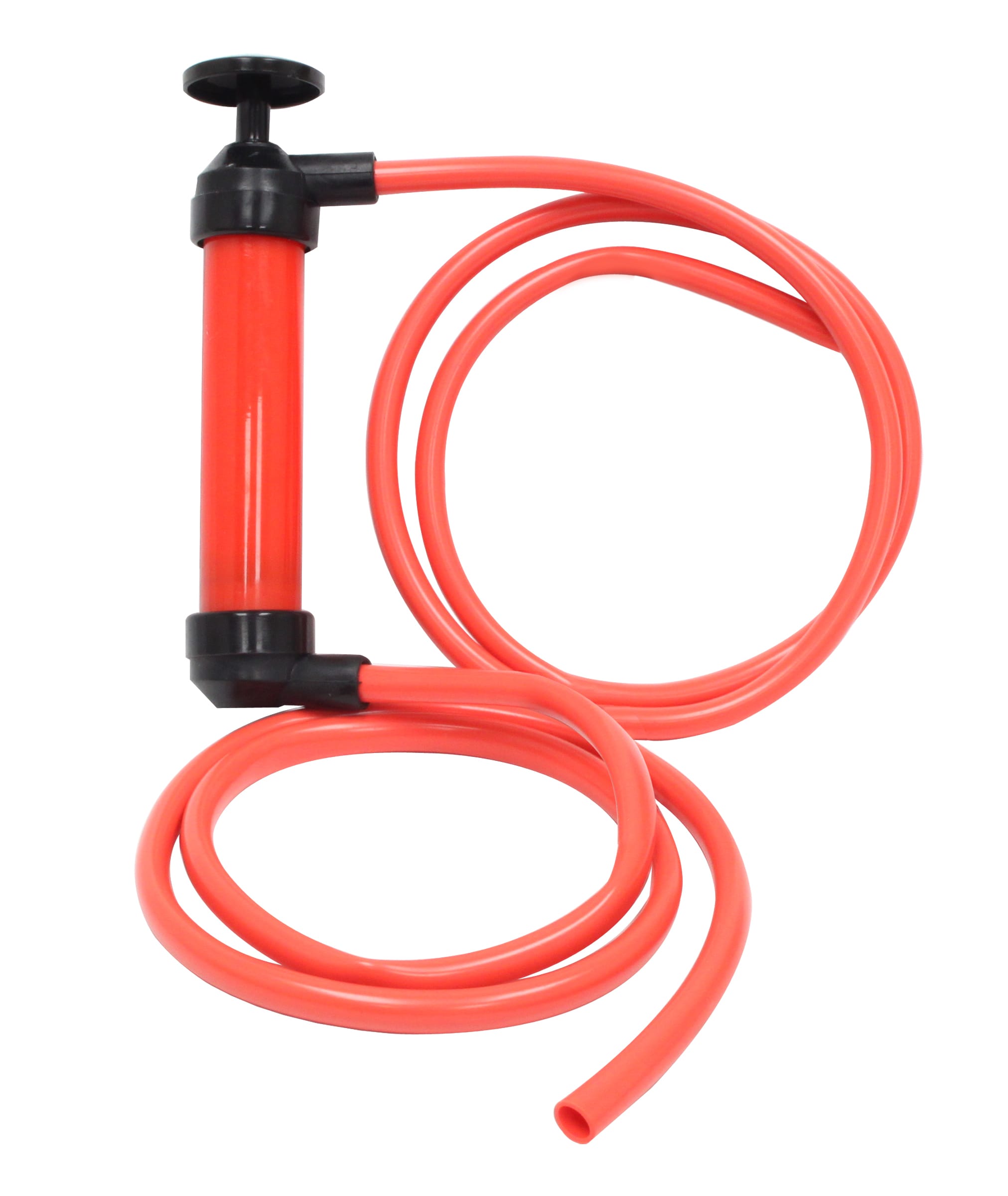

    use valves and hoses and buckets and a pump and you can do it anywhere, no drips (if you use the hose clamps!!), just need a hardware store to recycle the oil
    EZ drain valve
    EZ OIL DRAIN VALVE
    EZ drain hose attachment
    STRAIGHT HOSE END
    two five gallon buckets with a good lid lock/seal and pour spouts, hand pump, some clear hose and a couple hose clamps from home depot
    next time i'm gonna get a mini drill powered inline pump, got to work smart

    You'll be pumping forever with that POS. I used to do it that way. Then I got the lid with a handle pump built in and was still PIA. Now, I have a wide mouth funnel I put at the oil fill neck between the block and air pimping and just slowly dump the oil in. Such much easier and faster.
