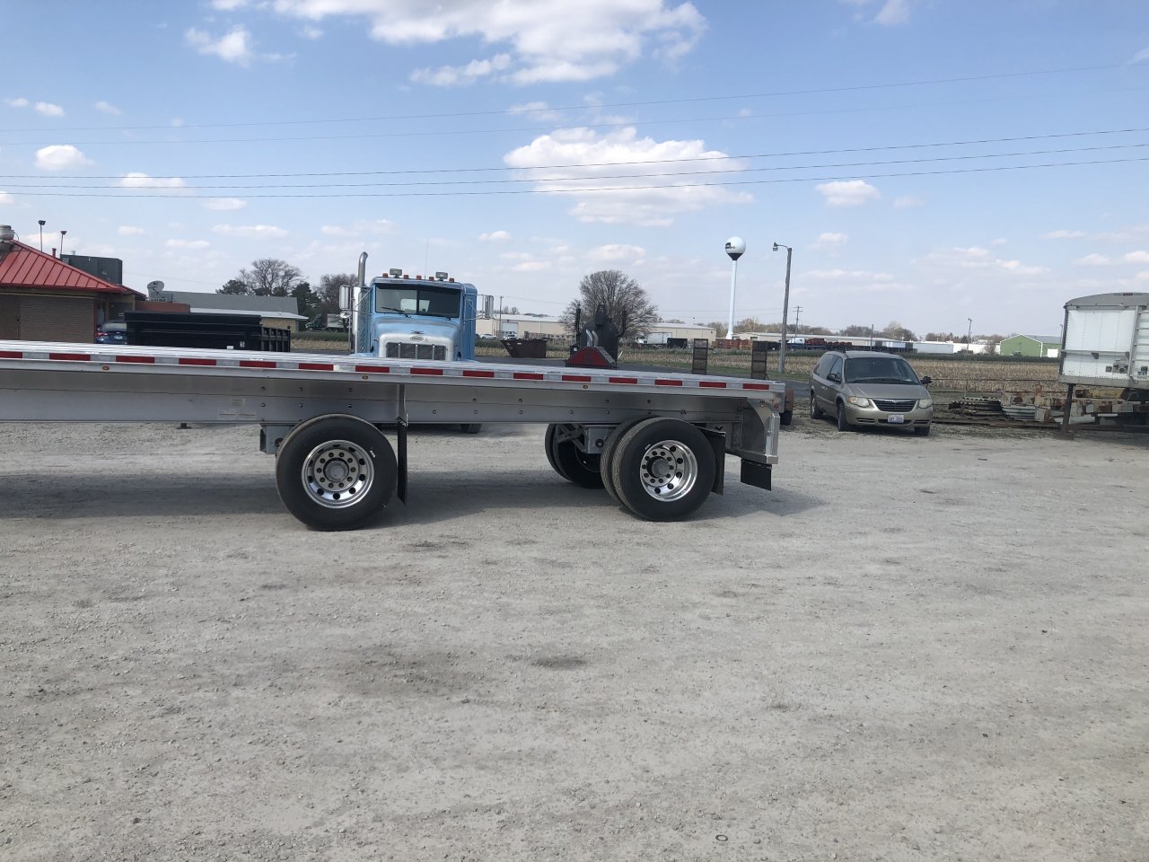

    Got er unloaded and drug to the barn. Tried to scale it at the elevator but couldn’t get a consistent weight because I can’t fit on all in one shot. 82D88E5E-A146-4D59-B81D-9DB6F934B364.jpeg 61F26BFE-AEAD-46A3-8EA2-4EB3B94CA79E.jpeg I had to make a temporary mount for the airlines till I get everything measured out. New king pin is 36 compatible to the 18 on the old one. 3A1E2DA6-8259-4FD3-8CAA-19FEAE136600.jpeg But after careful review and some calculated assumptions I’m of %98 belief @cke got the better value on trailers this week?
    Good score there buddy and happy birthday!!!
