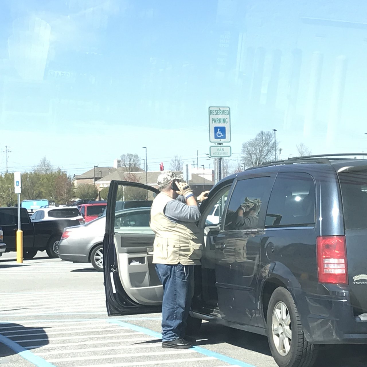

  6. OLDSKOOLERnWV
    Joined:
    Messages:
    19,261
    Thanks Received:
    291,355
    Location:
    Why is he wearing gloves and what appears to be a shooting vest?

  8. rank
    rank Road Train Member
    Joined:
    Feb 11, 2010
    Messages:
    9,919
    Thanks Received:
    113,510
    Location:
    I thought it was supposed to do that. Kind of smart I thought. Put it back in when you're done and drive her home.

  10. Crusader66
    Crusader66 Road Train Member
    Joined:
    Oct 21, 2016
    Messages:
    2,647
    Thanks Received:
    68,689
    You mean the driving gloves, or the shooting vest or being parked in a handicap spot or even though it looks like guy, it could be a girl and she's pregnant?
