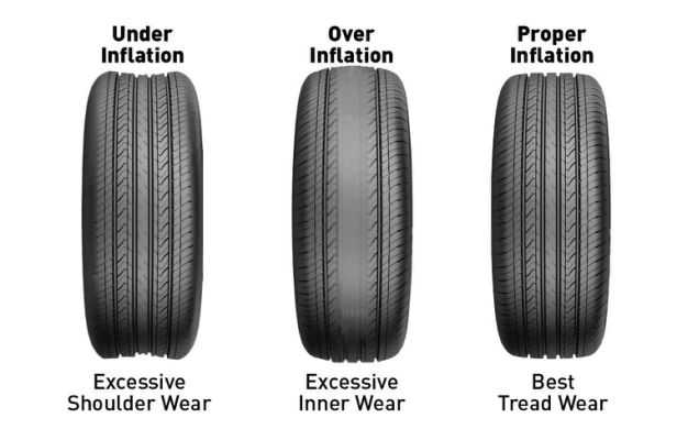

    120 psi ? hmmm. I am not Michelin specialist but I would put 100 psi(cold) ...

    Some people who run light loads do only run 110.
    Since i pack max weights usually i run 120.

    For me, that’s too high unless your tire sidewall mentions 120 PSI. Also, make sure your truck was not in direct sunlight (preferably night time) during the at least 4 hours of no rolling. Lastly, you want a PSI for the average load weight you haul. Do not use 110 PSI if you constantly haul light loads. You will develop tire wear in the center.

    I actually think the pressure is too high. When those get hot your probably doing 130+.
    That’s way too high for just regular dry van type running IMO. Unfortunately those tires will never be the same but I’d still set them at 100. My Dad always set his at 90 to 95 and he ran cross country back in the day. I thought 100 was high. lol.

    For most people who have 11,800-12,000 on their steer axle, then 105-110 will work. The dual tires in a tandem are a bit different. Michelin actually says something like 80-85 if I recall correctly. I do not follow their advice on that one. I use 105-110. By the way, Michelin charts are based on your type/size of tire and your load weight. Here are all the charts.
