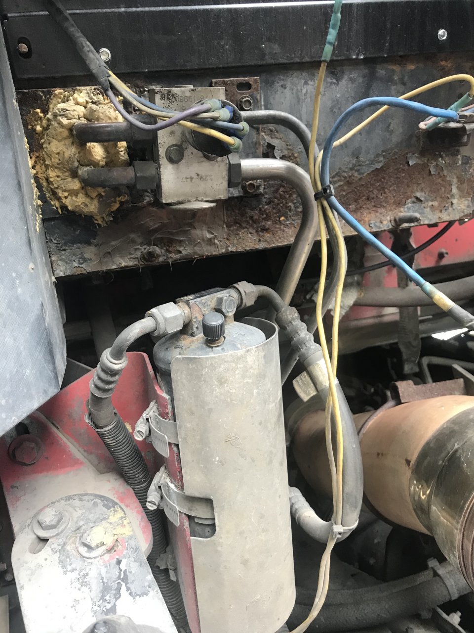

    D57D4EAD-6795-402B-BAB2-633F5076224E.jpeg A87458DF-5D8D-405E-87C0-AD73471618AD.jpeg D57D4EAD-6795-402B-BAB2-633F5076224E.jpeg Tried loading the system with freon yesterday, after pulling it down and checking for leaks. Now I’m no AC guy at all and had a friend there who knows a little more than I do. Hooked the lines up and put the first can in. Tried another can and it wouldn’t take it. The compressor is engaging and disengaging and looks pretty new. Could it be the compressor, drier or expansion valve, not allowing more freon into the system?

    Could be a bad expansion valve, but maybe the high pressure switch is bad, and shutting it down, You can unplug it and jump the plug with a paper clip, see if compressor stays running. Keep an eye on pressure, if you let it run for any amount of time, or charge it up, don’t want to blow anything. Best Jump it to diagnose, and replace if necessary, before charging up.

    York compressors are crazy #####y about contamination, and will lock up in a heartbeat. Make sure if you take anything apart, to clean thoroughly. If you are having trouble taking freon, and jumping the high pressure switch doesnt work, expansion valves are cheap. I'd replace both. Along with the reciever/dryer.

    Sometimes it takes a while, especially if it’s cycling. Once it stays on, sometimes the last can or two, can take a long time. Maybe even an hour. The system can also take a long time to adjust itself. It’s easy to get impatient and over fill it. Best to start with an empty system, and only put in the required amount. Foolproof. Those York clutches aren’t very good. Slightest bit of heat, and they’re toast. Once they sieze up, almost always overheat the front compressor seal, and bearing, ruining the compressor. They’re pretty cheap, and easy to change. Only 4 bolts, might be the problem. It would be a good idea to upgrade to a Sanden, eventually. Save yourself a lot of grief. Find a similar Truck with a Sanden. Use that vin for parts.

    Most likely expansion valve. Just change both and install new drier while system is dumped. They are cheap and usually pretty easy to chAnge and about 90% of the time the culprit of the conditions you are describing. And yes to who ever said to change from a York to Sanden.
