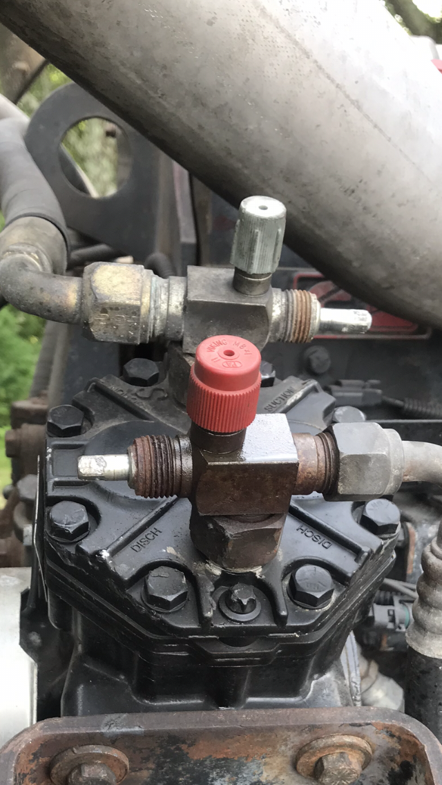

    4CF5201E-AC30-44D1-9893-3C3F11C41D44.png I ordered a new expansion valve, drier and trinary switch. In this pic the valves are screwed all the way out. When adding freon to the system do the valves on top of the compressor need turned, in, out, or in the middle? Where do they need be set after the system is full?
    Rideandrepair Thanks this.

    I think they’re just shut off valves. No need to touch them at all.
    beastr123 Thanks this.

    I’m not sure but if you’d screw it in all the way, wouldn’t it close the line and if you backed it all the way out, it’d close the port that goes into the top of the compressor? I’m not sure but they adjust for some reason.

    I would think if you screw them in, it closes the Compressor and the line off. Screw them out to open them. Normal operation should be out all the way. Nice if changing the compressor, without losing all the Freon. Ideally shut offs at every component would be nice. But more chances for leaks.
    mile marker 27 Thanks this.

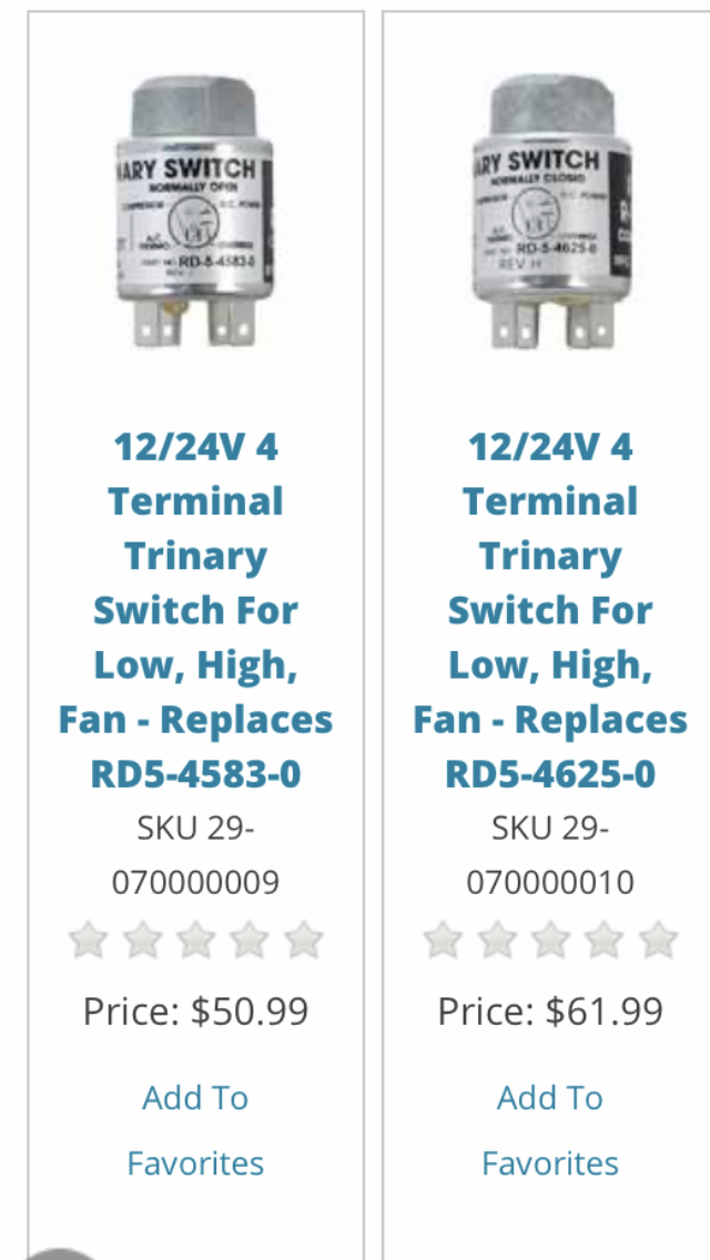

    EBAC2EE9-E599-44A7-8D7B-7B366AEE3C54.png Wanting to replace the trinary switch, that screws into the expansion valve. The labeling has worn off mine and 4 States offers two different ones. The only difference I can see, is that one says, “normally open” and the other says, “normally closed”. Which do I need?
  10. Rideandrepair
    17,584
    56,957
    Aug 8, 2015
    Look at the old switch. See if you can still read it. Should be NC, or NO, stamped on it. Or maybe the RD#, for reference. Otherwise, a Kenworth Dealer can run your vin #, and get you the right one, or at least tell you, the part#, if they’re out of stock.

    Almost positive that screwed all the way out is normal operation. Mid ways is for charging and all the way in shuts line off .
