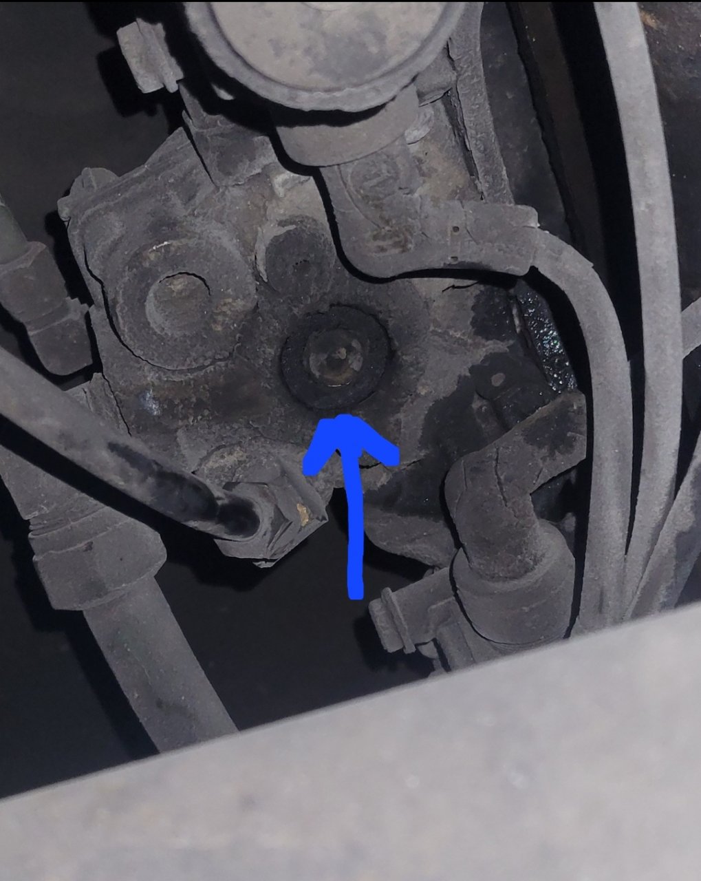

    My big ABS valve is leaking from the rubber thing directly in the center when I push the brake pedal. It only happens when the parking brake is pushed in (released). I got a DOT violation from it today. Replace the valve or could it be a bad brake chamber? See pics attached.

    The words should be there now. Accidentally hit post before I put the text !

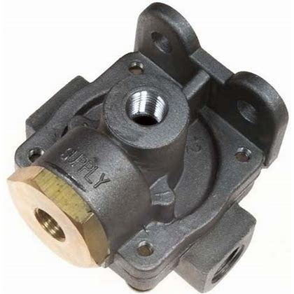

    Pinch off the blue line between the quick release valve and the abs valve. It will probably quit leaking then.
    If so, replace the quick release valve.

    The shop rebuilt those air valves with new seals and it didn't fix the problem. So i had them replace the 2 front drive axle brake chambers and it fixed it. So turned out a bad brake chamber was my issue.
