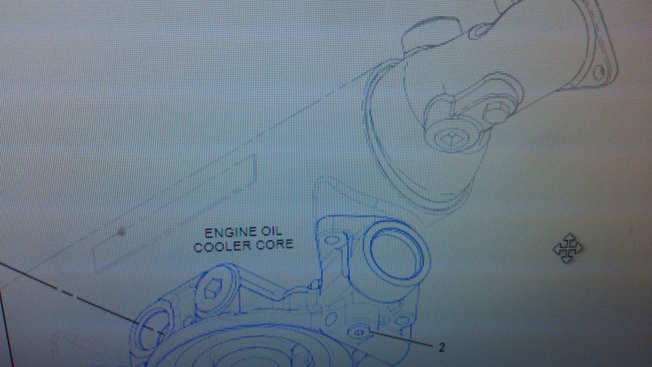

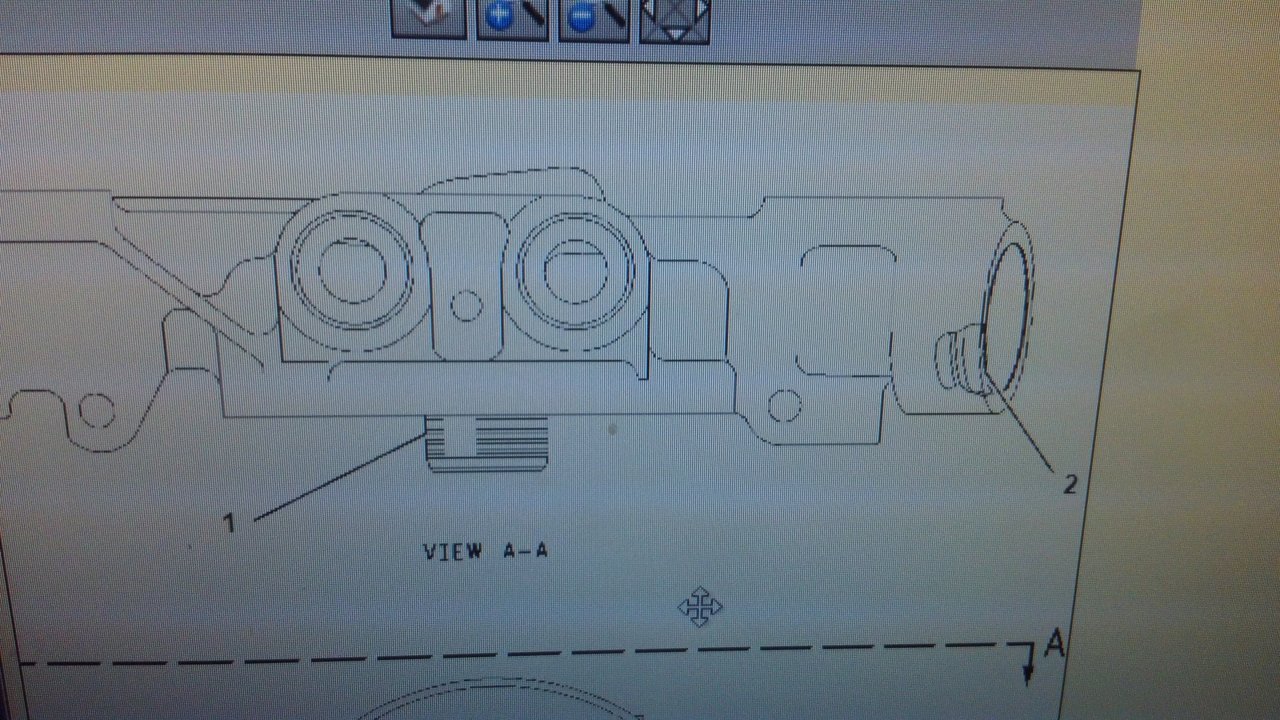

    I know this is an old thread but anyway I've got a cold weather leak that popped up on my MBN recently that seems to be coming from the freeze plug in front of the oil filter just below the oil cooler. When the ambient temp is around 25* or lower it drips. Anyone ever seen that before? I'm pretty sure it's coming from the freeze plug (pic below) and not the oil cooler. Can I just knock the old freeze plug out with a punch and then use a socket/hammer on top of a new one to seat it in?

    You can get the plug, but it is oil it is sealing not coolant. I would guess it is the bonnet o-ring. KIMG1680.JPG KIMG1681.JPG KIMG1682.JPG

    Well this is coolant leaking and so from the diagram # 22 is where the leaky o-ring is running down and dripping onto that freeze plug? Right now it's not leaking. I suppose being based and mainly running in the southeast I could probably wait until next winter to get on this?
