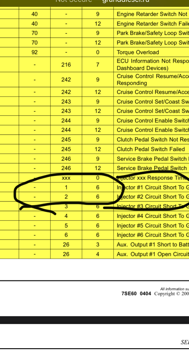

    06 ddec 5 12.7 I got this code off a scan gauge. Can u please tell me what it is and the cure is.
    Pic below of code.
    TIA

    The first number 1 just says the current selected code
    The ID 1 according to a quick google detroit and scan gauge says "There is no sensor assigned to this value"
    THE FM 3 according to your user manual page 38 says "Voltage above normal or shorted high"
    The CNT 1 is just the amount of times it was detected.
    PRobably a lose wire and only detected once somewhere but good luck with that and i would just clear the codes and continue on my way

    On another search showed injector 1.
    Thanks for the reply.

    Thats not a injector code
    Y-L Thanks this.
  7. Y-L
    Y-L Light Load Member
    93
    50
    Oct 1, 2013
    Maybe I’m reading this wrong. That’s what made me think injector.
    I’ve been dealing with low power for some time now.
