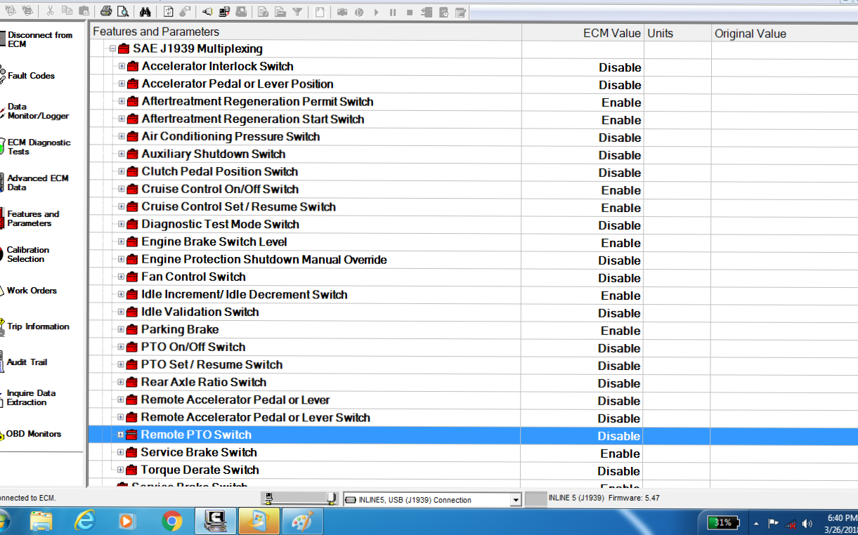

    heavyd, on a earlier post you mentioned about body controller not sending signal to ecm for the engine fan to turn on, i think i have that problem getting code spn:2609 fmi:16. my fan is not turning on for a/c, which i think it gives me high pressure. what should i look for in parameters in the ecm. and what do you think should be changed. thanks

    If you have a Cummins, under Features and Parameters
    Fan Control - set to ENABLE
    Air conditioning pressure switch - DISABLE
    Fan control switch - DISABLE
    Fan type - ON/OFF
    SAE J1939 Multiplexing should be ENABLED
    Air conditioning pressure switch - DISABLED
    Fan control switch - ENABLED
    Source address - 33 BODY CONTROLLER
    johnnydngrs Thanks this.

    i will recheck the high pressure sensor,wiring when my truck gets back. one thing i did noticed in insite is no SAE J1939 Multiplexing ecm value,should it be like that? like i cant enable or disable, its just blank. and fan control switch disable. ill try to change those too. thank you very much for your help.

    If you are able to expand the little + sign and open up that column, then it is enabled. Is this a screen shot from your truck? If so, the fan control switch is not set up correctly. Once you enable that, you can click the little + sign next to the fan control toolbox, which open the little toolbox and more options will become available. This is where you set the parameter to Body controller 33. This tells the ECM to accept fan control commands from the body controller through the data link.

    cool so i do have multiplexing enable. yea thats a screen shot from my truck. when i go back to the truck on thursday, i'll enable fan control switch and make sure source address= 33 body controller. im thinking this has been my problem all along. thank you
