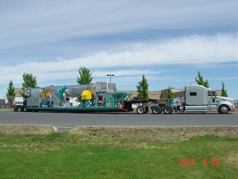

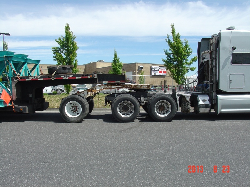

    We make our Jump Jeeps with Air ride suspensions. Welding the axles to the frame ("Solid axle" no suspension) derates them quite a lot, not even close to 20,000 lbs rating on a 22,500 lb axle.
