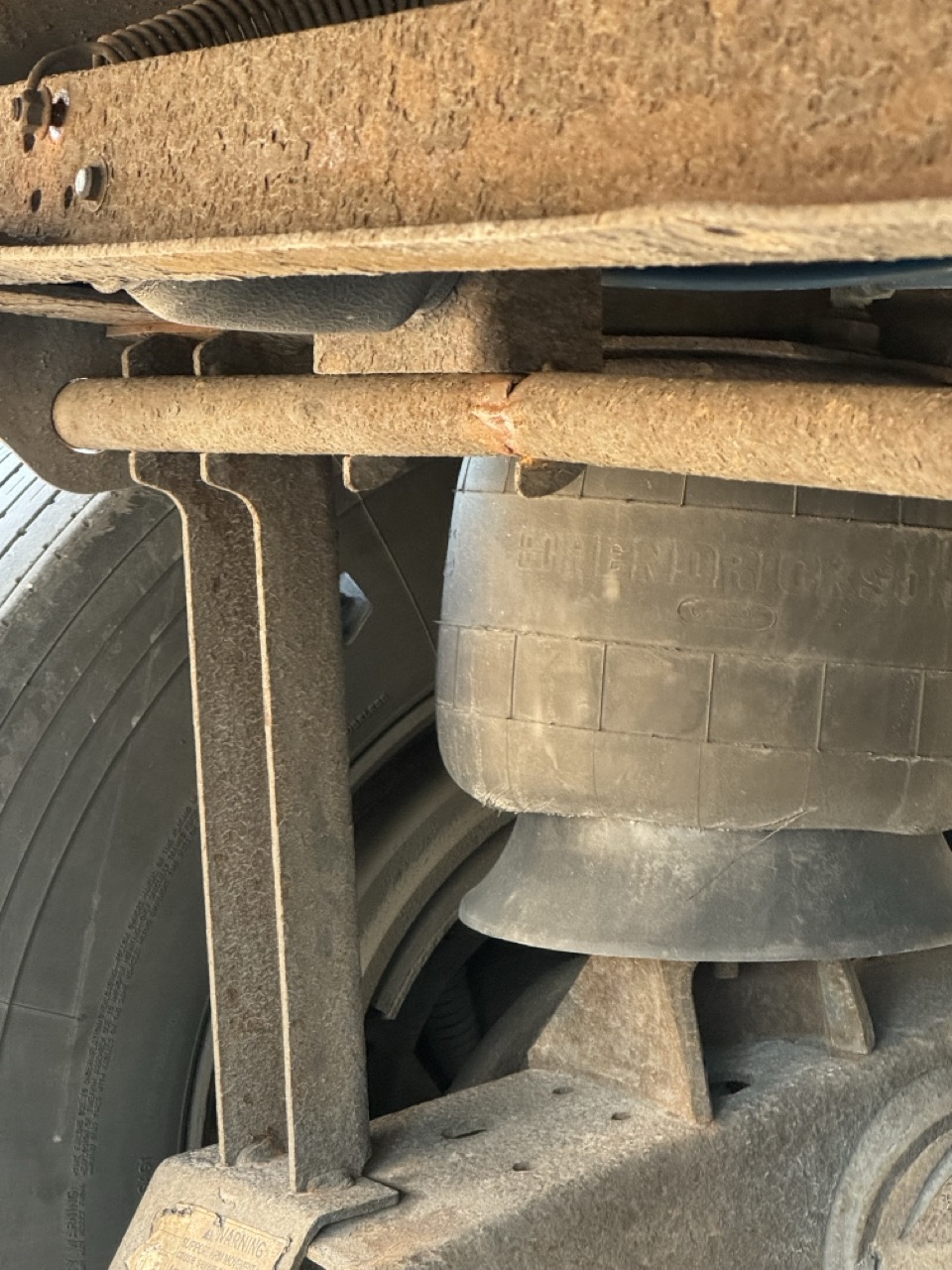

    The airbag on that tire doesn’t look as inflated as the other 3.

    Might be a PITA, but I'd try to scale each position independently with a load. May be the the one locking up is lighter. That's why I asked about the air bag.
    Possibly the bag was replaced with the incorrect one

    IMG_5243 Large.jpeg IMG_5252 Large.jpeg Can someone tell me what this is called and what it does. They say it’s broken and that might be my problem

  10. Big Road Skateboard
    7,445
    42,461
    May 2, 2021
    That's a support stand. Could keep weight off one side if it's completely broken and 1 side stays down

  11. chowblower
    chowblower Bobtail Member
    13
    8
    Nov 18, 2023
    That’s what the guy told me at the TA but he say he can’t say for sure but it’s a possibility it might fix my problem since I’ve gotten everything possibly done on the wheel already. He called it something else though. I can’t remember what he said. He did say I’d have to go to a trailer shop to get it fixed. I was trying to look up the part online to see how much it cost
