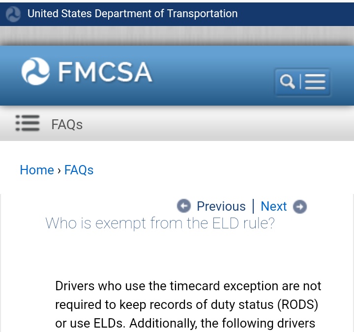

  4. Mark Kling
    Mark Kling Technology Contributor
    10,935
    4,216
    Sep 23, 2007
    Statesville, NC
    Oldironfan Thanks this.

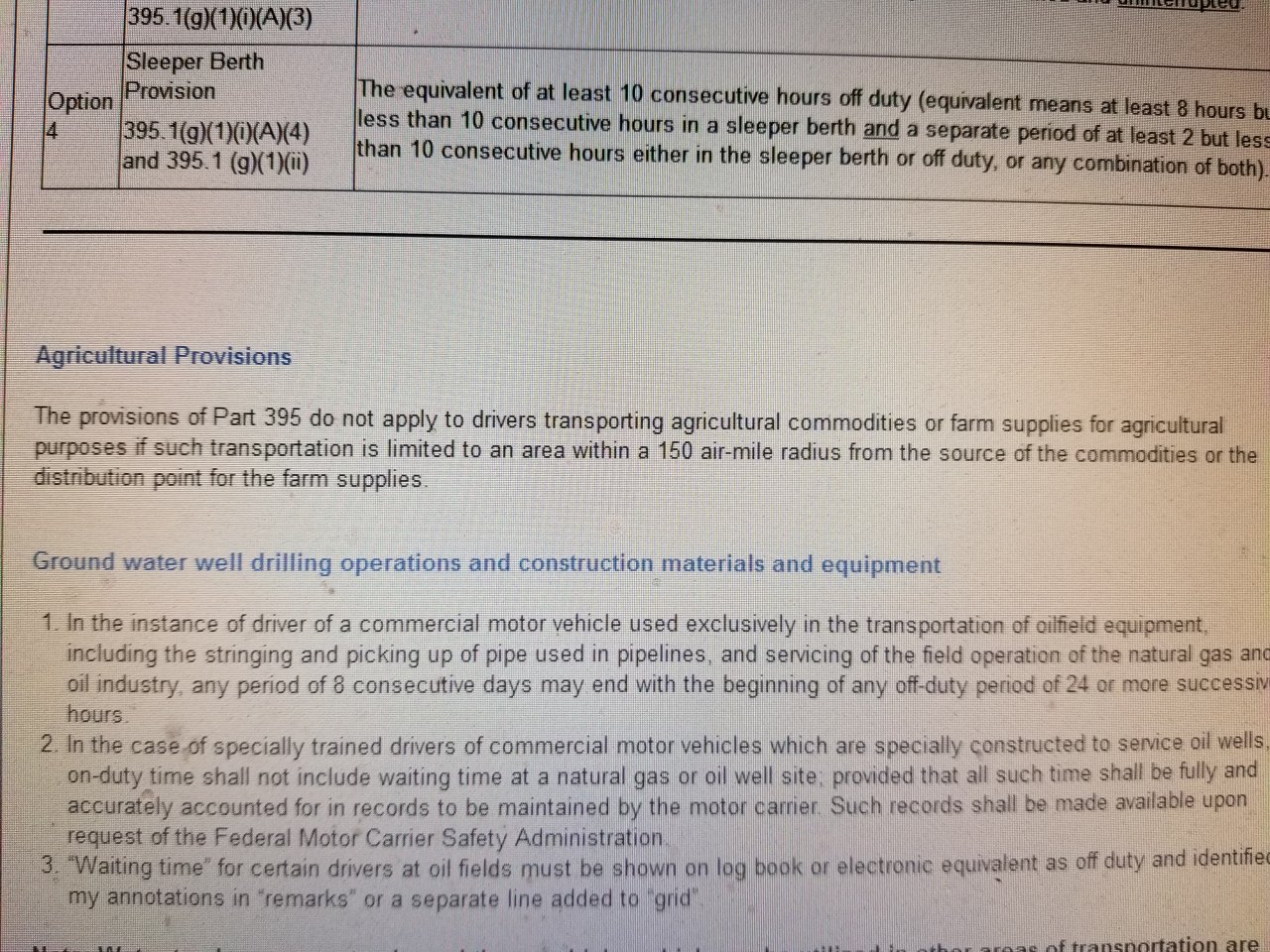

  5. Mark Kling
    10,935
    4,216
    Sep 23, 2007
    Statesville, NC
    But under the 100 mile... they went over thinking they had 150..
  6. my bad. i mixed two regs
    farm permit is 150 miles
    rods are for over 8 days in a 30 day period.
    Oldironfan, MACK E-6 and x1Heavy Thank this.
