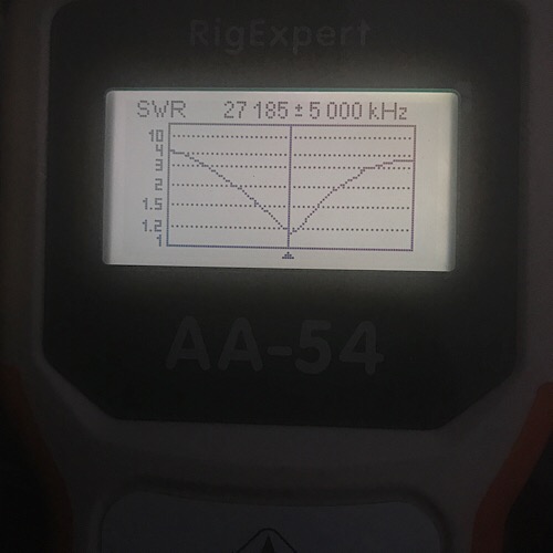

    IMG_952.jpg IMG_953.jpg IMG_954.jpg Well it's up and running. Here's what the numbers look like...
    I had to go with a ten inch Wilson shaft and no spring. With just the antenna, it was at 29.185 mhz. Added the spring and it came down around 28 mhz. The ten inch shaft put it right on the money for channel 19 and still good for 38 lsb.

    I would tweek some more to get your x closer to zero bs -7.1
    I have looked many times to see how much on either side of zero makes a difference but never found anything...I just get anal and stick it at zero give or take a point
