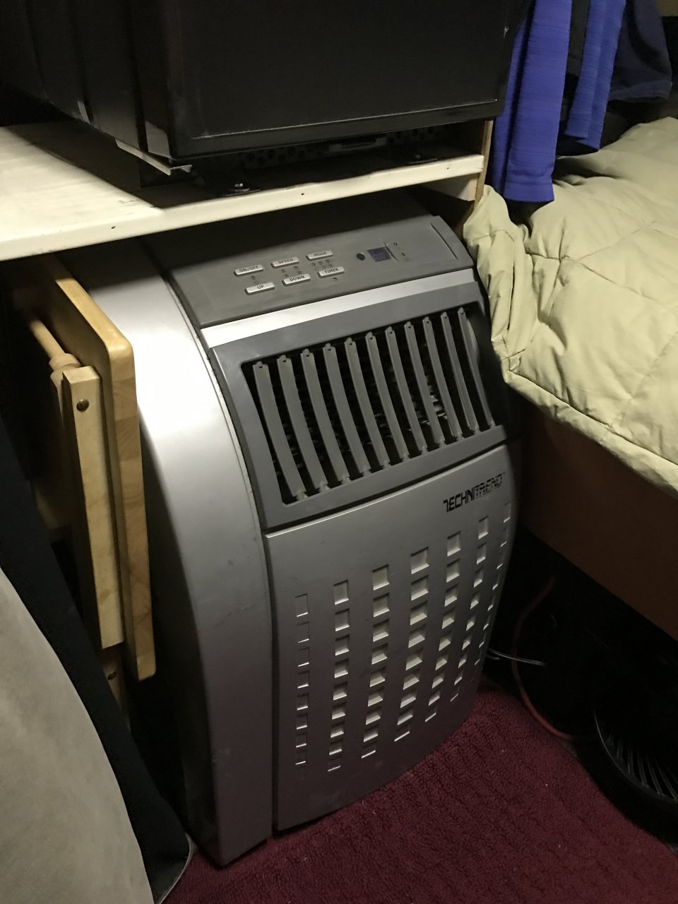

    image.jpg Get a double hose one, 2-6" holes in the floor with shields. They make them with heat too but I suggest the under bunk HEATER for the best effecincy and quietest option.

    This is one option that I would/have considered to underbunk.
    I agree that it needs to be a double hose unit, (1 hose is exhaust, the other intake. Both are sepperate from the living area and are used for cooling the unit only)
    My issue with this style is fitting it in without major surgery of my cabinetry.
    What is the make/model of yours? How long have you had it? BTU rating? Would you buy the same one again? And lastly, what was/is your method of powering it?
