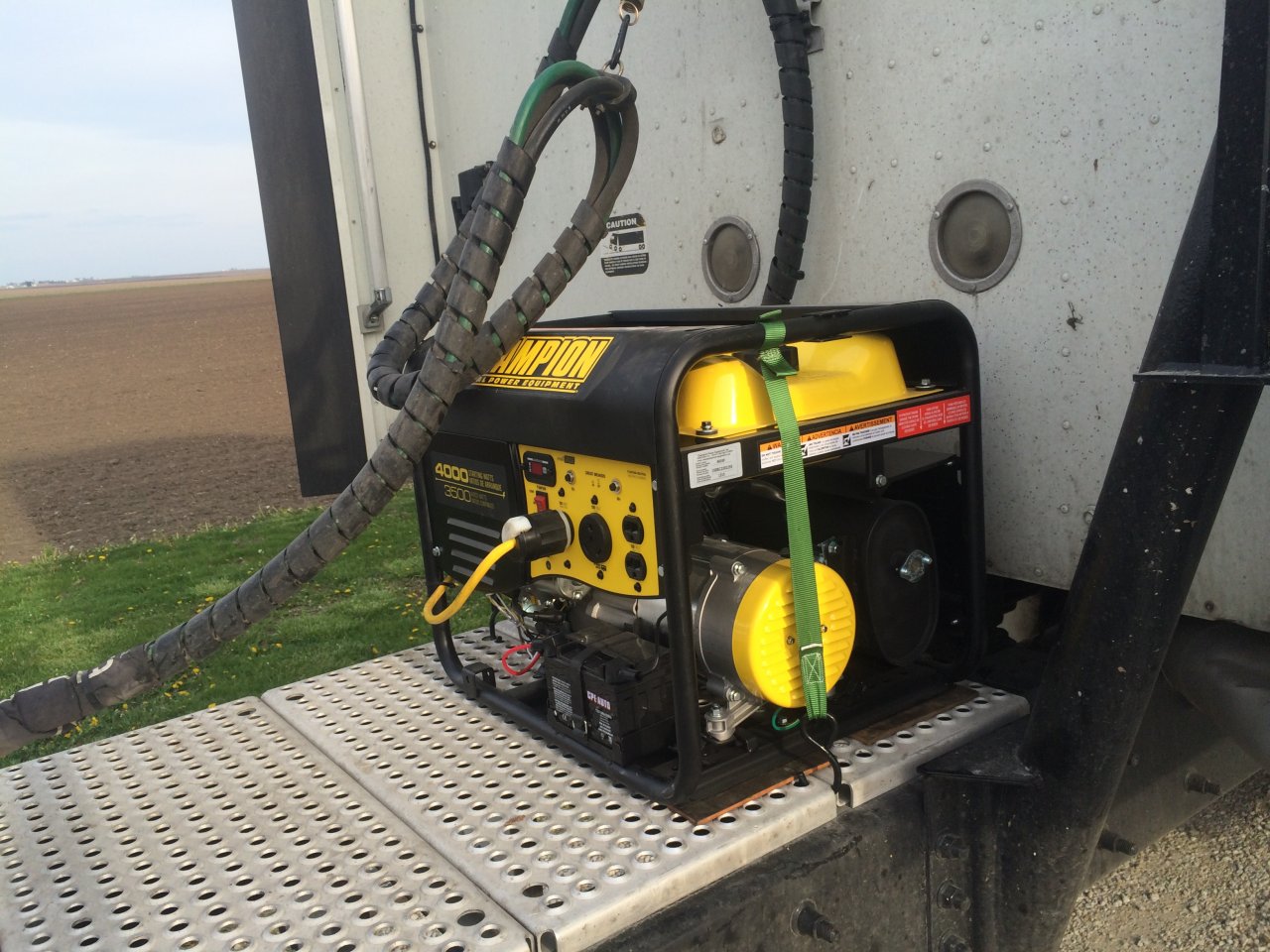

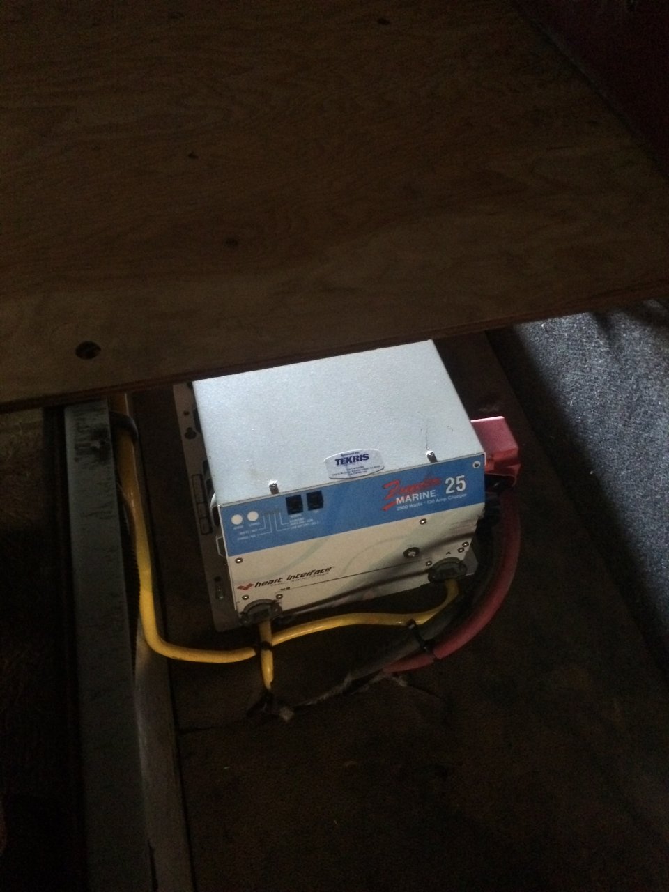

    This one is a single hose 8000 btu unit I have had at the house for over 5 years. It doese ok in the Midwest but is underpowered in Texas. I bought a double hose 13k this fall when they went on sale for under $400 IMG_1040.JPG IMG_1029.JPG but have not put it in the truck yet. I run a remote start 3500w champion unit and a motor home inverter/batery charger. IMG_1037.JPG

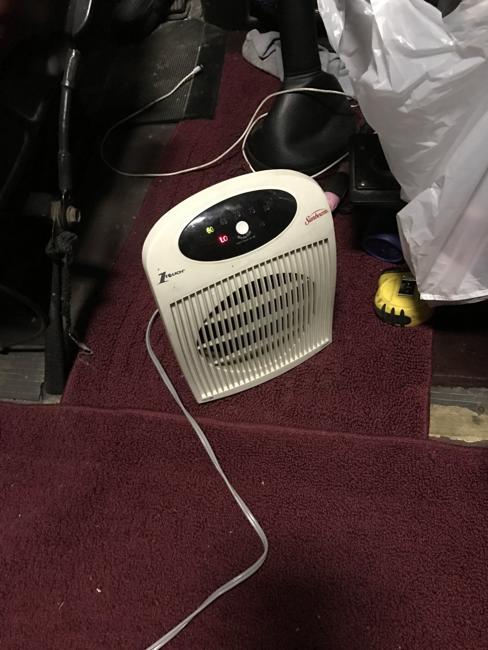

    I use this for heat in the winter. On sale at Walmart for $11 last spring. I don't like running the gen all night just for this so I will be getting a stand alone bunk heater next year I think.
    Generator is $.39 per hour to run over the 800 hours I have run it plus the cost of the unit at $399 shipped to my doorstep. Remote start was the big seller for me.

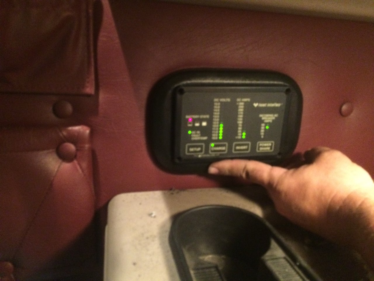

    The inverter/battery charger is a shore power too. So when I start the gen it automatically switches to the gen and when I shut the gen off it switches back to the battery. When I'm home I just plug it into the house and batteries are fully charged and fridge still running after the weekend.

    I know I'm going g to regret this as I do not want to derail the topic...
    I already pretty much have the choice of my powerplant down and decided... But, I just looked up the champion generators. They seem to be pretty inexpensive. Cheap enough that once it starts giving a lot of problems it would be easy to just trash it and get a new one.
    So... Tell me about yours. Which model do you have? How long have you had it? How many hours are on it? Problems? Run time on a tank? And very important.. How noisy is it?

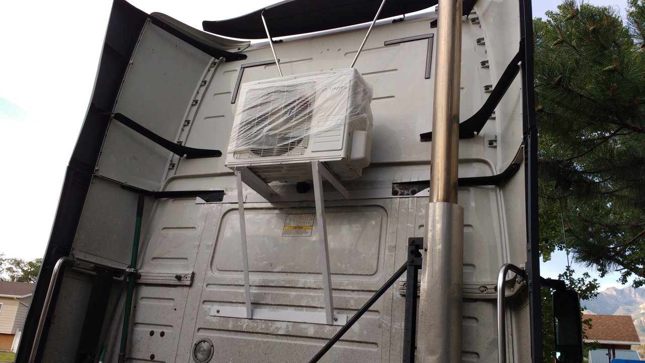

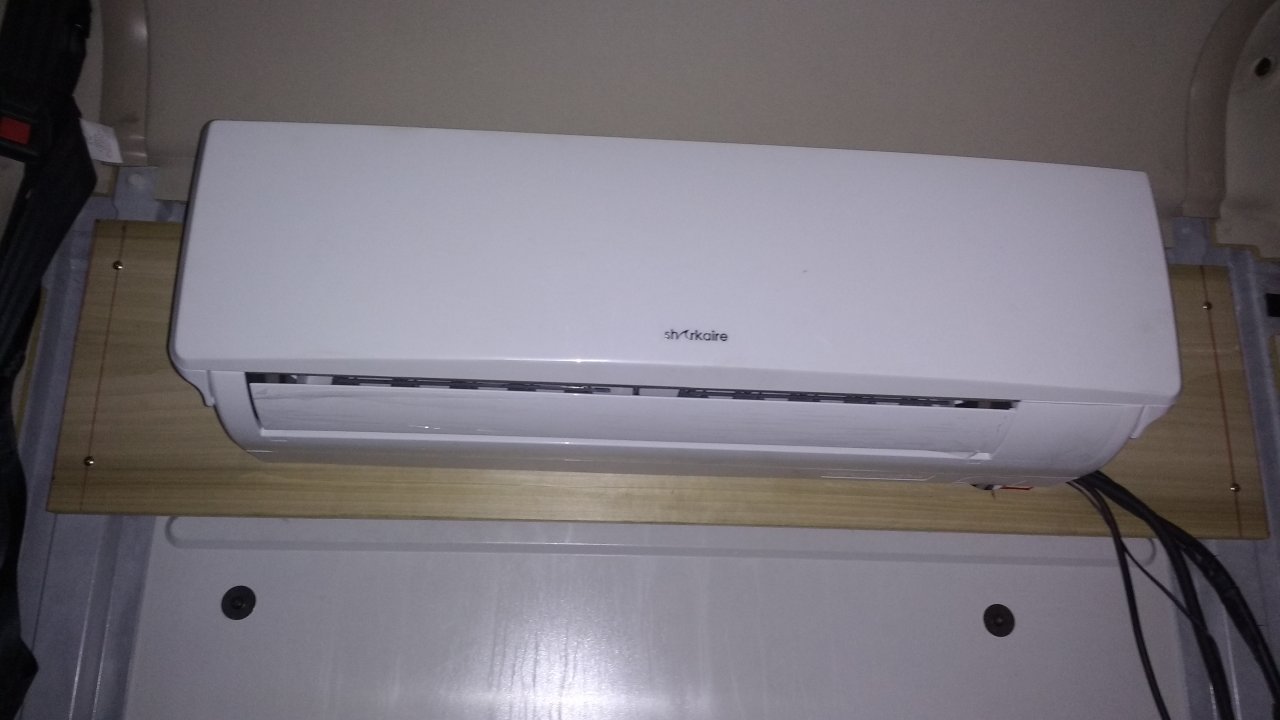

    Very nice and I was actually looking at a split system very much like that earlier today.
    Now that you have jumped in...
    Make and model? How long have you had it? How is it holding up?
    And... How do you power your set up?
