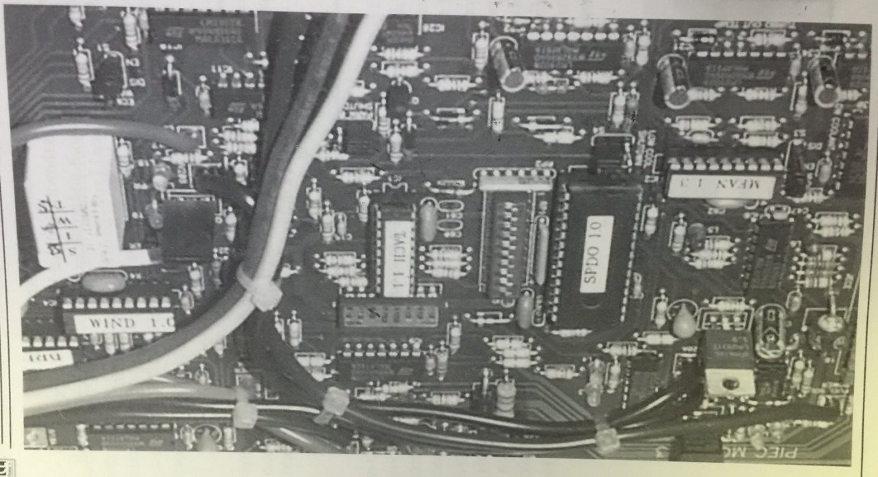

    Here is a pic of the computer behind your dash. Right in the middle is a set of slide switches. I think the override shutdown switch is #1. There should be a description of the switches on the back panel of the cover.
    I read my manual and in your case, low coolant for more then 30 seconds will cause a shutdown. Setting this switch will prevent this.
    heavyhaulerss Thanks this.
