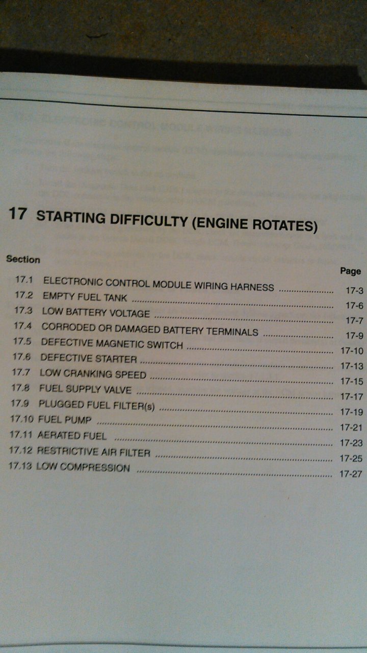

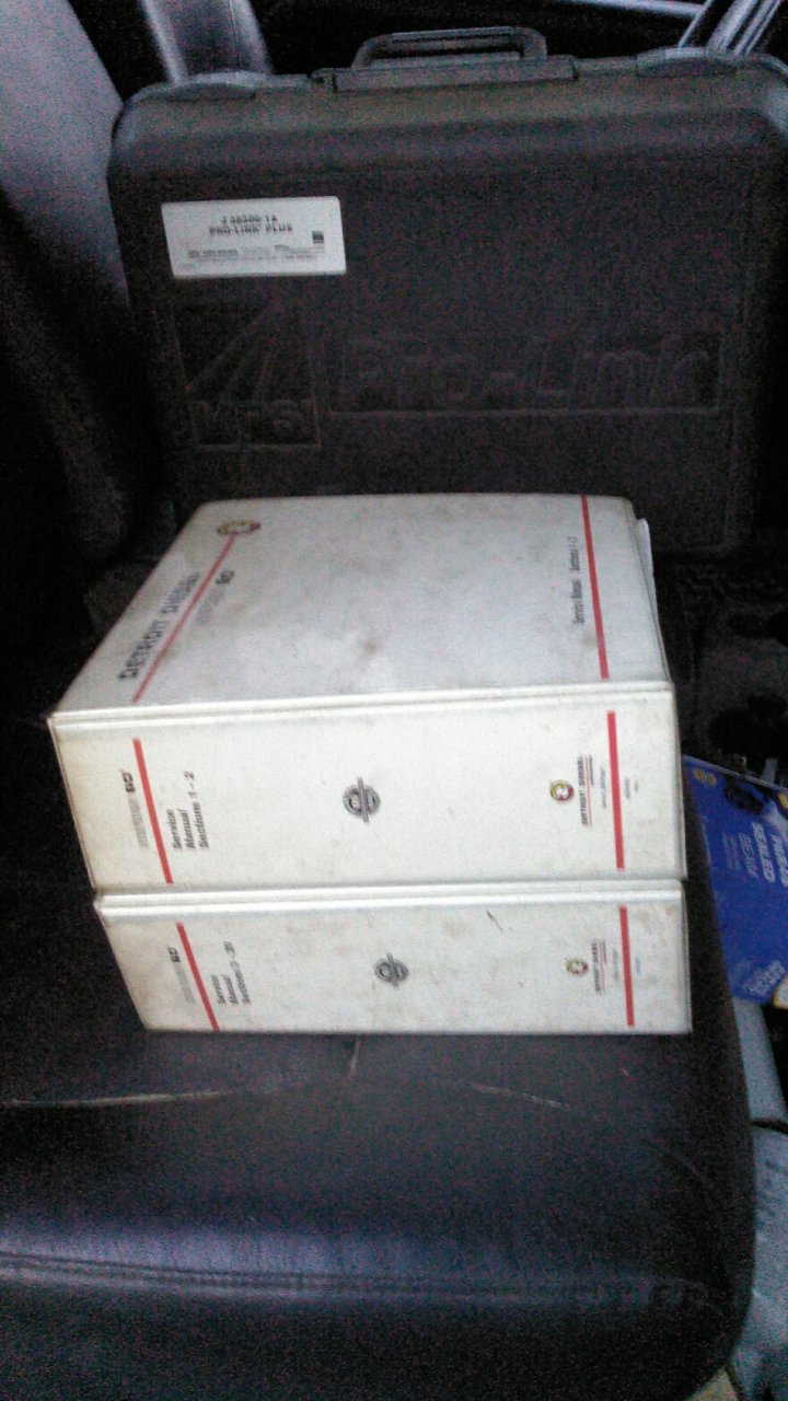

    I am not real sure what to tell you but I brought some home work with me. KIMG1430.jpeg Is there anything here you would like some more info on? KIMG1430.jpeg KIMG1431.jpeg
