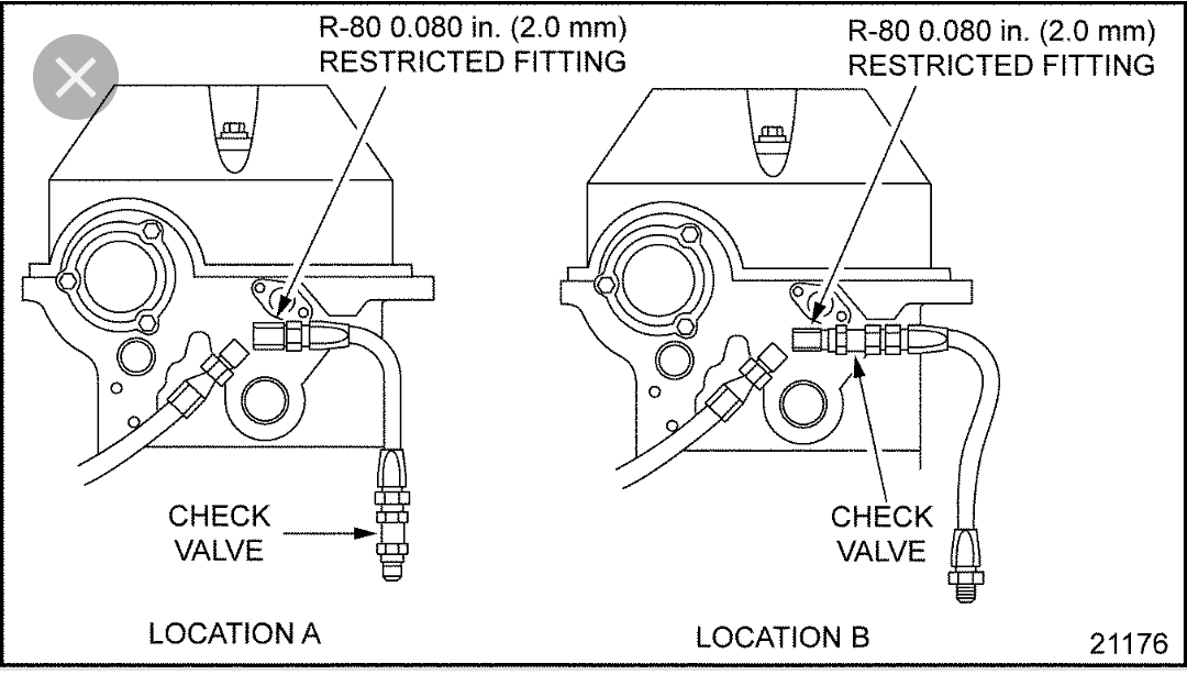

    Ok, Swan. Wow! I found the check valve. It was in that little spot between transmission frame and fuel tank. Would have missed that completely as somebody on here had said my year fld never had one. Crow is good by the way as I am close to the same spot you were 200 miles from home. Come to think of it, if it helps get my truck running, even OLD CROW sounds mighty appetizing. Lol. So. I got this thing off. It was so tight I was curious if threads were gaulded. Lol. It came off in pieces. And they don't have one in stock, will have to order one if I replace and it is like $100, but looks pretty simple. Just a plunger between 2 fittings. No springs nothing. I put it back together. Blew in both ends takes air on engine side, none on other side.

    Not sure who told you no check valve but more false information. That engine would never start in the morning without one.
    Glad you found it. Good luck and I dont want to sound negative in any way but I still dont think its fuel related.
    Also there is no fuel seliniod or shut off on a series 60.

    Truck is 96 fld. Motor 12.7 ddec 3. It was an old penske truck 2 owners ago could be interesting the owner I bought the truck from was sure it was losing an injector. That waa 250k miles ago, though lol. I haven't taken the valve cover off, but there is only one solenoid with wires coming off and it is on the sec fuel filter assy. Somebody said earlier that measures fuel temperature though. I have had it out and that is exactly what it looks like. And I am having your same thoughts. I am kinda think in right now, I found this check valve and hose is still apart, I think I might put a small bucket under it and screw valve back on return so air don't go both ways and see if I can get fuel. This may also kill 2 birds with one stone on the solenoid I will report back.

    Lol. Swan. Sometimes when you don't know any better it is trial. Error and learning experience. I am really enjoying this forum as I can tell you a bank of money has been thrown at this. And the alternative? Just take er on down there to Detroit ..and pay them $150/hr to put the 3th rpm guage in. Lol. I can eat a lot of crow and admit to a lot of stupidity before that. Lol.any way I went start to check valve .got fuel all the way. No fire. Swan is sounding very wise.
