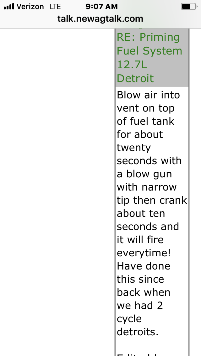

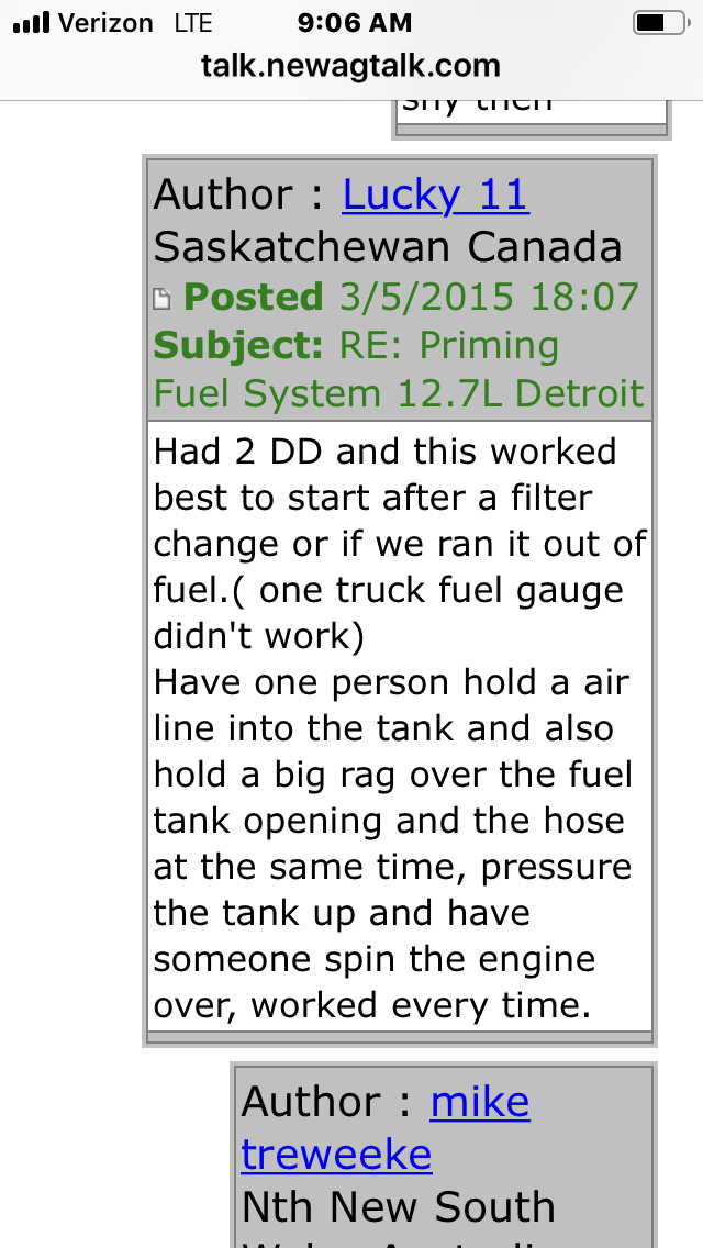

    1444082B-6721-41FC-A924-851D83263234.png 3F51E7DF-2354-4DEF-99C4-03C745F4E7A6.png Looks like I’m not the only one to use such a method to prime fuel system

    Can you please humor us and pressurize your tank it won't take much (so you can rule that out) instead of jumping all over the place. Take the advice that is giving to you.

    Dude. I have pressurised tank and got fuel though the system. I even for####'s and giggles disconnected the check valve and pump and sucked it backwards through there. I think there may be some fuel in the head.
