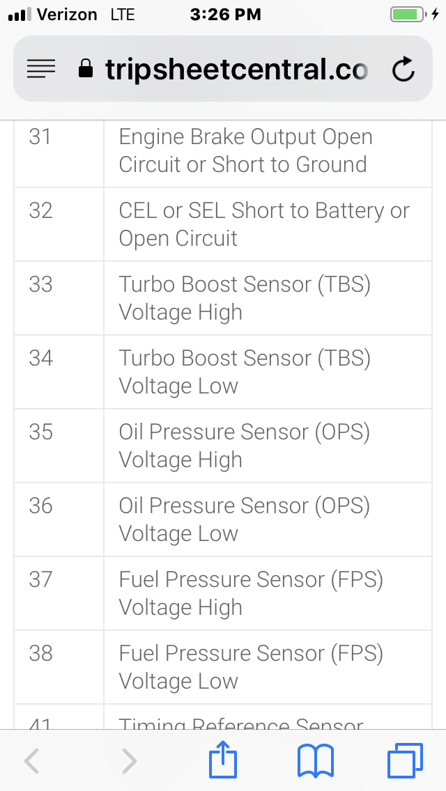

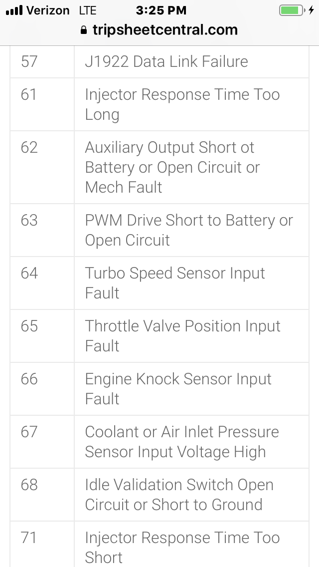

    Ya. I was looking for a fella but I can tell that is a lost cause till maybe tonight. I found this book thing on my phone. Looks like it is pretty informative about codes. I am going to print it in town right now.
