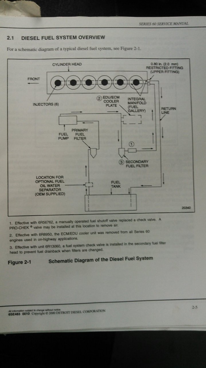

Ha Wanna: Been busy chasing my own rabbits. You did not find a check valve because it never had one.
I bought these books when we bought White GMC,s with S 60.s. Ours had Davco fuel water separaters. They had a check valve on the inlet.
