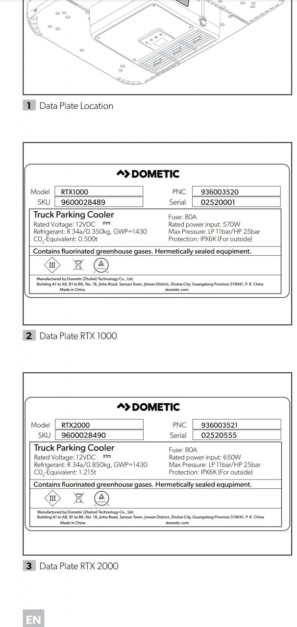

    The dometic website states 19 amps, but only in eco mode.
    When you get to the manual
    Small unit, 570 watts is 47.5 amps at 12v. (Plated to 50)
    Large unit, 650 watts is 54.1 amps at 12v. (Plated to 58)
    These are max inputs, so presumably thats on the max settings.
    I stated originally that a likely draw would be near 40 amps. Dometic seems to agree.
    If all you want is eco mode, by all means, a single 200 ah capacity is plenty.
    But its not arizona im worrying about, its the muggy states in june and july.
