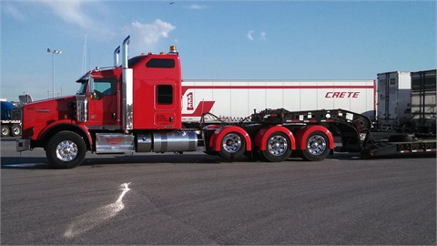

13 Axle Setup?

    3:42 rear axle ratio>you need a much lower ratio than that...3:90's would be more appropriate and a set of 2 speed rear ends would be the cat's meow! What Provinces in Canada only allow 12K on a steer axle?

    My 2013 Oversize Reference book shows 12,100 on the steers for Alberta and 12,125 for New Brunswick
  4. passingthru69
    You can get more on the steer in Ab. Depends on tire size also. The best thing is to check their website for Ab.

    Exactly, most of those "books" are full of glaring errors!
    I'll be with a bit of digging you can get verifiable proof that you can pack 14K for sure and possibly 16K on a steer axle across Canada.

    You could also look into a used tri axle dump. It will be set up for super heavy haul. Just make sure you know what emissions crap you are getting into.
