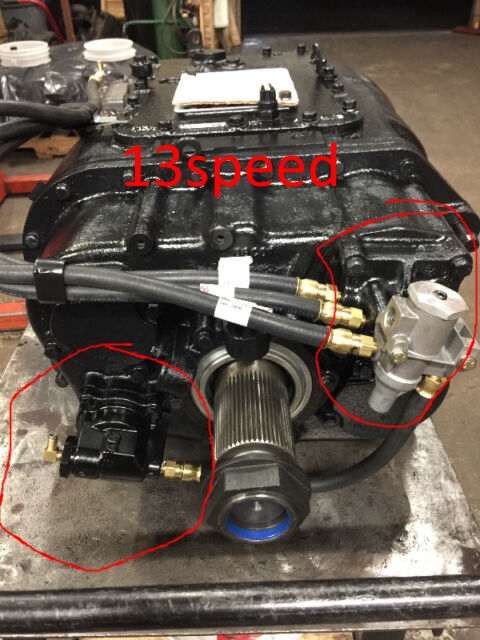

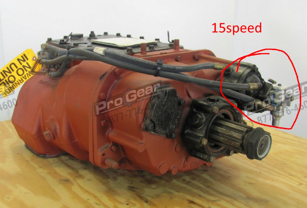

    My project has a 15 with it against the dash. Transmission is an RTX but the top cover was switched to an RTO to match the pattern sticker on the dash. Back box only has deep reduction, low range and high range, which is direct. Only OD is in the main.
    Last Call Thanks this.
  8. BoxCarKidd
    BoxCarKidd Road Train Member
    4,560
    6,646
    Aug 26, 2014
    I believe a 14715 and up used the combination housing you show. The 14615 and down had air shift cylinders on both sides of the rear box. Not trying to sling mud here. Just going back to there are many possibilities. I have put some 13 speed back boxes on 10 speeds. Just have to have the correct aux gear to make a mongoloid work. Guy at the salvage yard would not have a clue when one of these come in. Tag or no tag.

    The main box on the RTX/RTO-15615 is the same as a 15610. Can definitely see a mixup happening if someone was to make a 10 speed a 15 speed or vice versa.
