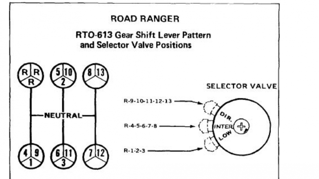

    The old up against the dash 9/13 was for overdrive models. The direct drive being the normal pattern. The old RTO series were the funky shift pattern with the big hole being up against the dash. The RTX series was the regular shift pattern along with RTLO of course
    The 93 came with a Rockwell 9OD against the dash before we put the RTX 14609B with the aux off of a RTO14613 to give us the old school .62 in the big hole. It's actually a triple OD .87 .73 .62 and with the regular shift pattern
    Edit RTOO like wore said not RTO has the U pattern

    The first 13’s series that came out before the rt and rto9513. Was behind a lot of gas burners.

    have one of these behind a 3208 cat in a brigadier in the yard kinda like a 15 speed but you only go back 2
