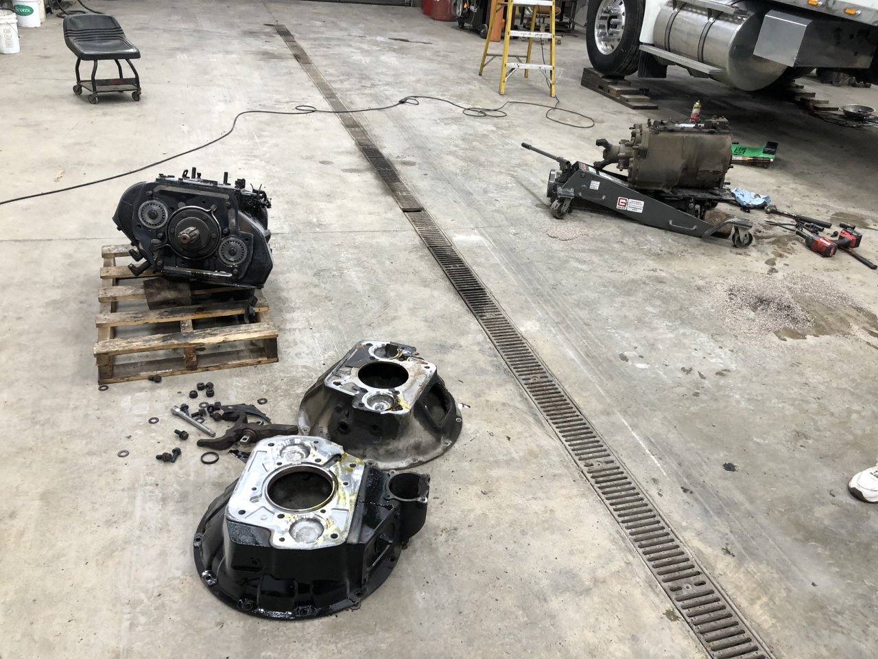

    I am new to 13 speed but I paid for it and installed it myself, if that gear was made out of glass they would lock you out if it. I use it instead of dropping to the low side all the time on corners.
    If it fails I’ll be sure to come back and report my findings. CD4391AD-3BE5-4AA5-9F2D-CC37107CDBF8.jpeg
