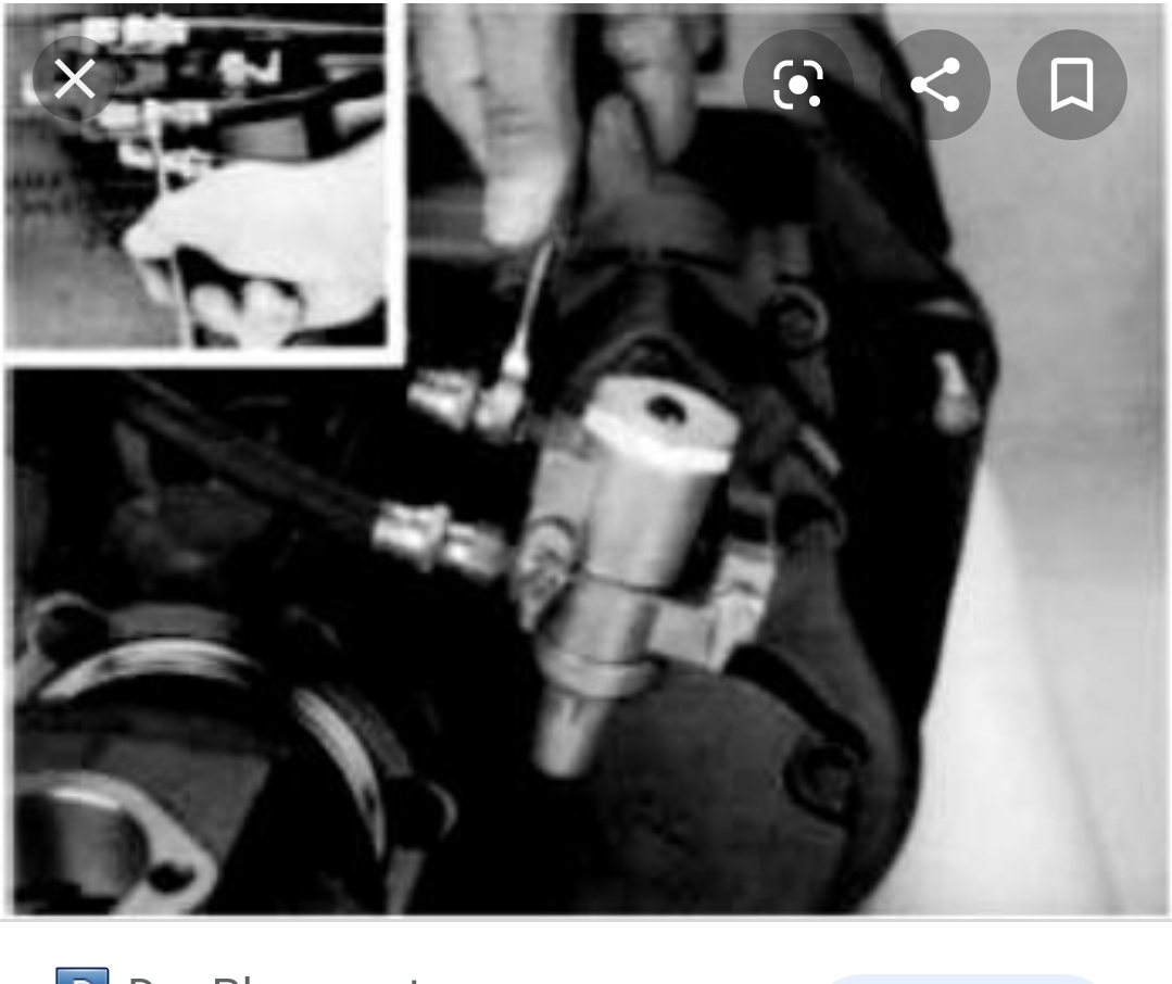

    I'll say it again.
    Have your transmission shop change out the regulator on the rear of trans.
    If you have full 120 psi air pressure going to the splitter or range selector you will get same symptoms.
    I mentioned earlier in this thread and no says a thing.

    If the regulator looks original and was never changed out I would just put a new one on and go from there. Perty easy swap.

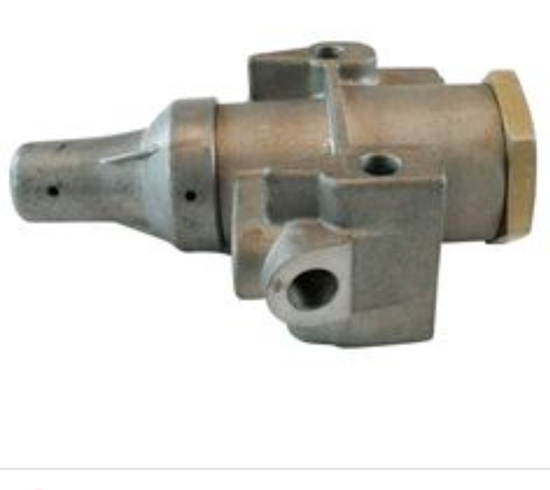

    Do you have a picture of that regulator?

    It's on the back passenger side corner of the transmission

    Every reman or transmission I get from my gear shop comes complete with all new air lines and regulator every time. No screwing around. Air pressure is crucial on these transmissions. Too much and gears get forced in to early and get damaged. Too little and splits or range shifts lag to long and gears get missed . Even air line ID makes a difference. Eaton had a tsb not to long ago out about that.
