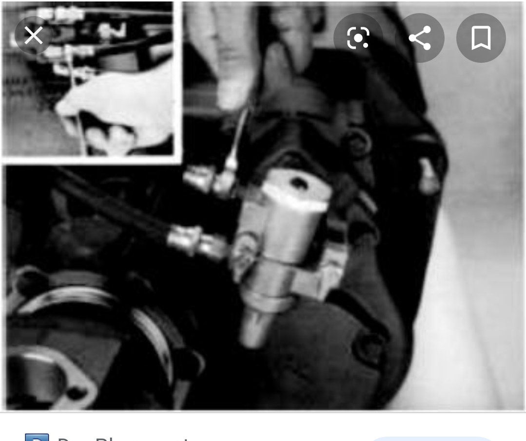

    What pressure does a trans use?
  4. swaan
    swaan Road Train Member
    2,942
    4,376
    Jul 12, 2009
    BC canada
    What ever that regulator is set at. If I'm not mistaken it's about 65-70 psi. Not 100% sure exactly.
    Just looked it up . 57.5 - 62.5 is what the regulator is preset at. Eaton does not recommend adjusting it , only replacing it.

    So my truck was at the shop since friday afternoon but they didn't have time to do anything with the transmission.
    I went there on Monday and replaced the pressure valve my self. I checked the pressure of the old one before I took it off and it was around 55 psi, when I installed the new one it was around 65psi. I'm not sure how accurate is the gauge I used, its from one of the mechanics at the shop.
    The problem is still there, I did a test run and still the same thing happens, when I preselect to go from 5H to 6L occasionally it downshifts back to 5L as soon as lift my leg of the pedal, it doesn't give me time to pull it out...
    I will have to take another week off in a while and have them pull it off and take it apart then...
