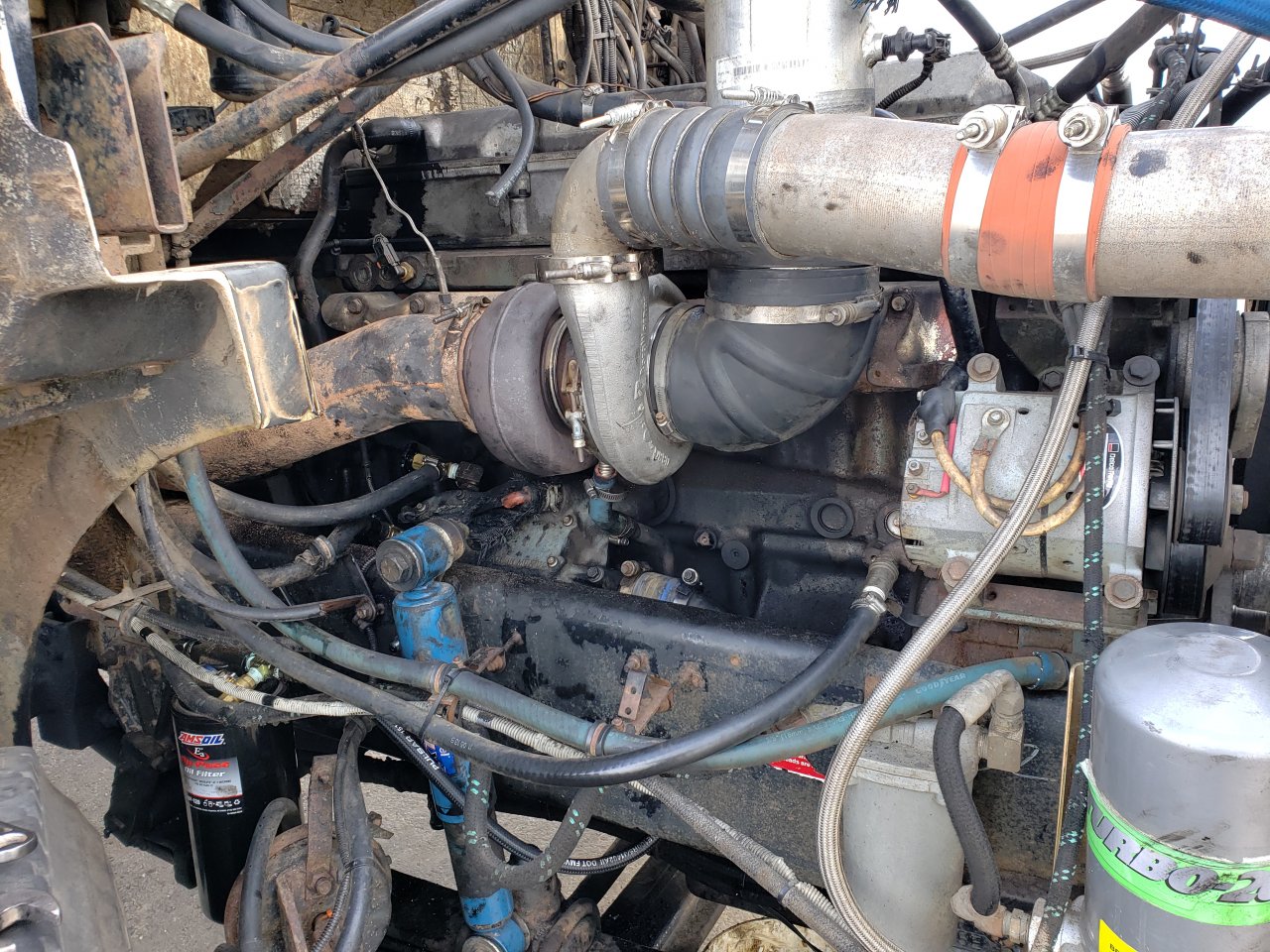

    Put it on a switch and see how it performs. It actually limits the power at the top end.

    I second Ben here, I wouldn't do it, have your tuner edit the file to give you a little more throttle responce instead. (Assuming they actually know what they are doing and arent just downloading a file they stole from someone else)

    Hey Dustin, did your fuel mileage change with the BW1717

    Yeah the mileage got better but most of that was probably due to the tuning.

    hey im on the same bost. installed a 171702bg and i hate the lag. but i dont wanna spend the money on bigger injectors. any tips?

    what motor do you have harold6091

    sorry fgt to put it
    12.7 ddec 5

    Do you have a tune? I'd imagine w/o a tune it wouldn't be fun at all to drive. Have one on a E-7 mack and one time i accidentally turned the tuner off (located by the injection pump, just a switch) and boy oh boy it was dead as Jimmy Hoffa
    Spend the money and it'll put a smile on your face

    12.7 dd5 you need more fuel for the 702 you prob should have went with the 701
