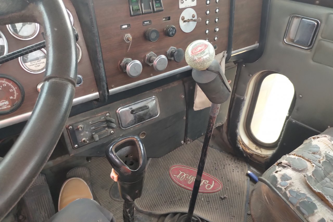

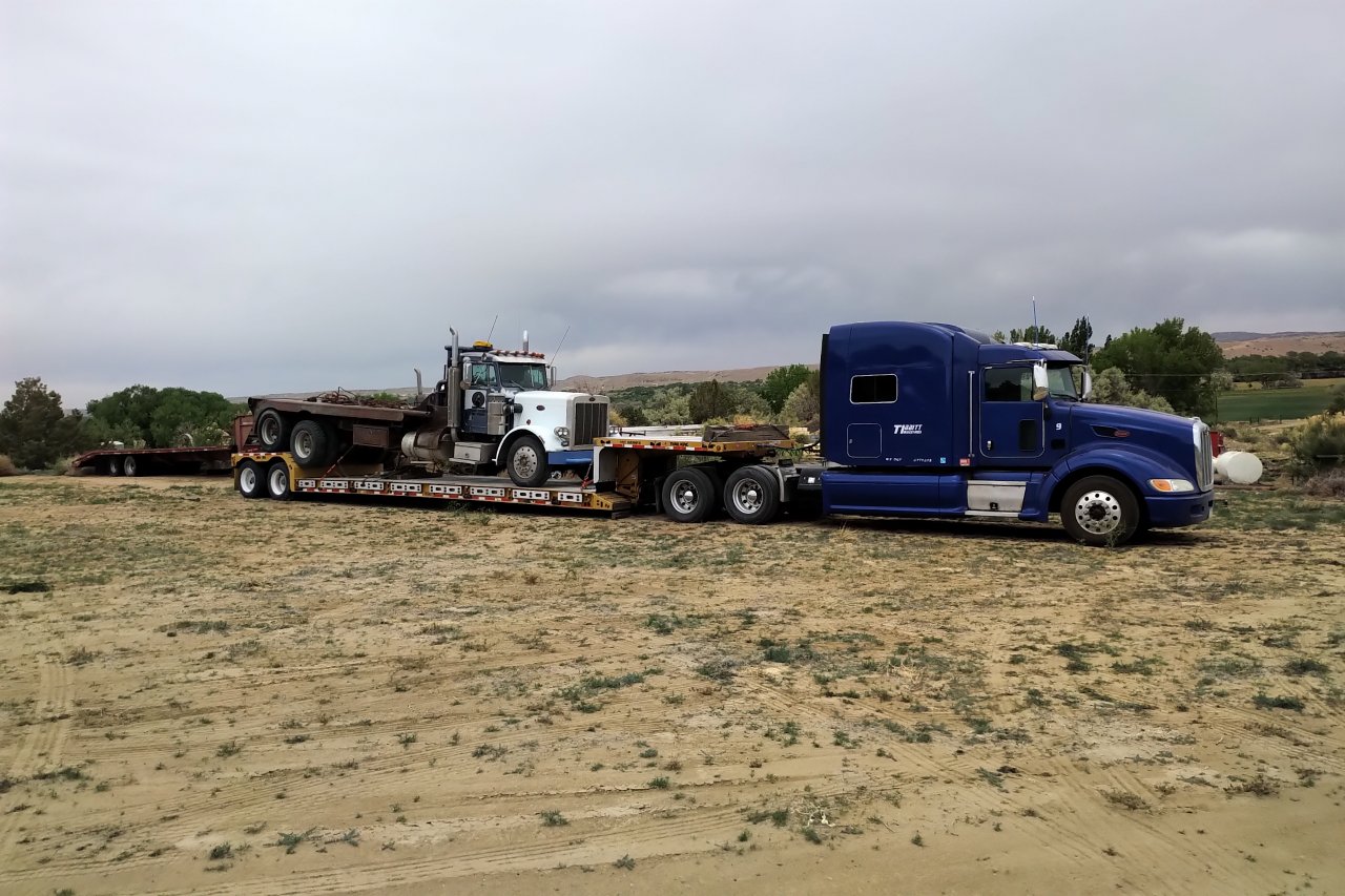

    I have nothing to add to this post other than I recently hauled a winch truck from the nm oil fields to the auction yard in PHX. And it had a 13 and a 4. I thought that was pretty cool. That was the first twin stick truck I ever got the honor of putzing around a yard at 10mph .

    That ain't a bad old looking mule .. for being in the oil patch
