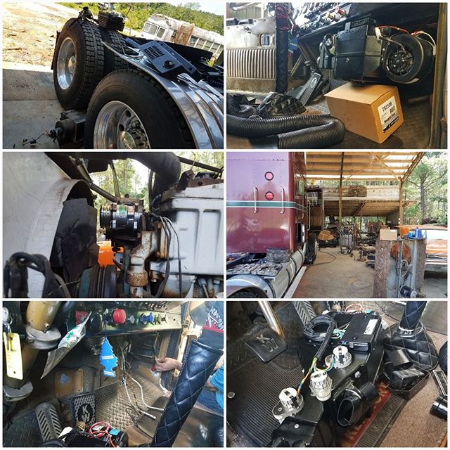

    Seroiusly, no, LOL. I just remember it being a Gen IV, 5,000 BTU model. It's the BIGGEST unit Vintage Air made they told me...that's all I got.

  9. AModelCat
    29,736
    165,163
    I was looking at their A/C units online. Just curious how it all tied in with fresh air vent on the passenger side cowl or if you just sealed it shut?
    Tug Toy and W900AOwner Thank this.
  10. W900AOwner
    W900AOwner Heavy Load Member
    715
    1,289
    Jul 2, 2014
    It doesn't tie in, the blower motor is wide open in front and takes air in right there. The only thing I should suggest and do myself is cover it with a piece of foam filter material to keep the dust and dirt from getting pulled through. Other than that it does a good job with everything.

  12. AModelCat
    29,736
    165,163
    Ok. Wasn't sure if it tied in or not.

    The actuator was N/G on my fresh air door on the passenger side anyways, so I just fastened it closed permanently. I use the drivers side one all the time for ventilation, it's a manually operated one like the bunk vent doors are.
