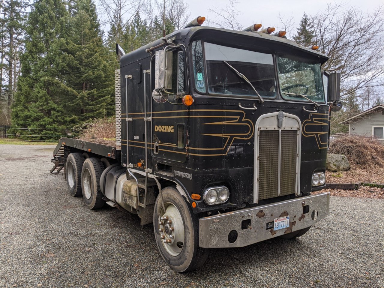

  8. flipper88
    flipper88 Bobtail Member
    42
    32
    Jan 17, 2020
    Got the truck home! Which was a journey all in itself... I was under the impression it would make the drive without issues. After getting a trip permit and a buddy with a CDL to drive it home for me we discovered it had an issue. It ran and drove great with plenty of power but would randomly shut off without warning. No shuddering just like someone turned the key off. Then it would turn over with no fire.
    After sitting for a few minutes it will fire right back up. It would do this about 4 separate times on a 30 min drive. Any ideas?
    Coffey Thanks this.
  9. Dino soar
    Dino soar Road Train Member
    4,817
    27,071
    Dec 8, 2017
    On that truck there is a solenoid on top of the fuel pump.
    When you turn the key on it sends electricity to the solenoid and it opens to allow fuel to go through.
    If that wire loses electricity for any reason it was shut the truck off like you turned the key off.
    Since it starts again after a few minutes maybe you are tripping a circuit breaker or the solenoid may be going bad. It runs through the key switch also so you'd have to check all that out.
    There's a screw on the other side of that solenoid. If you screw it all the way in that opens it and it will stay open without electricity.
    You can also run a separate hot wire to it and see if it will stay running that way.
    I'd like to see your engine. Take a picture of the driver side and take a picture of the passenger side especially where the oil filter is.
    Coffey and spsauerland Thank this.
