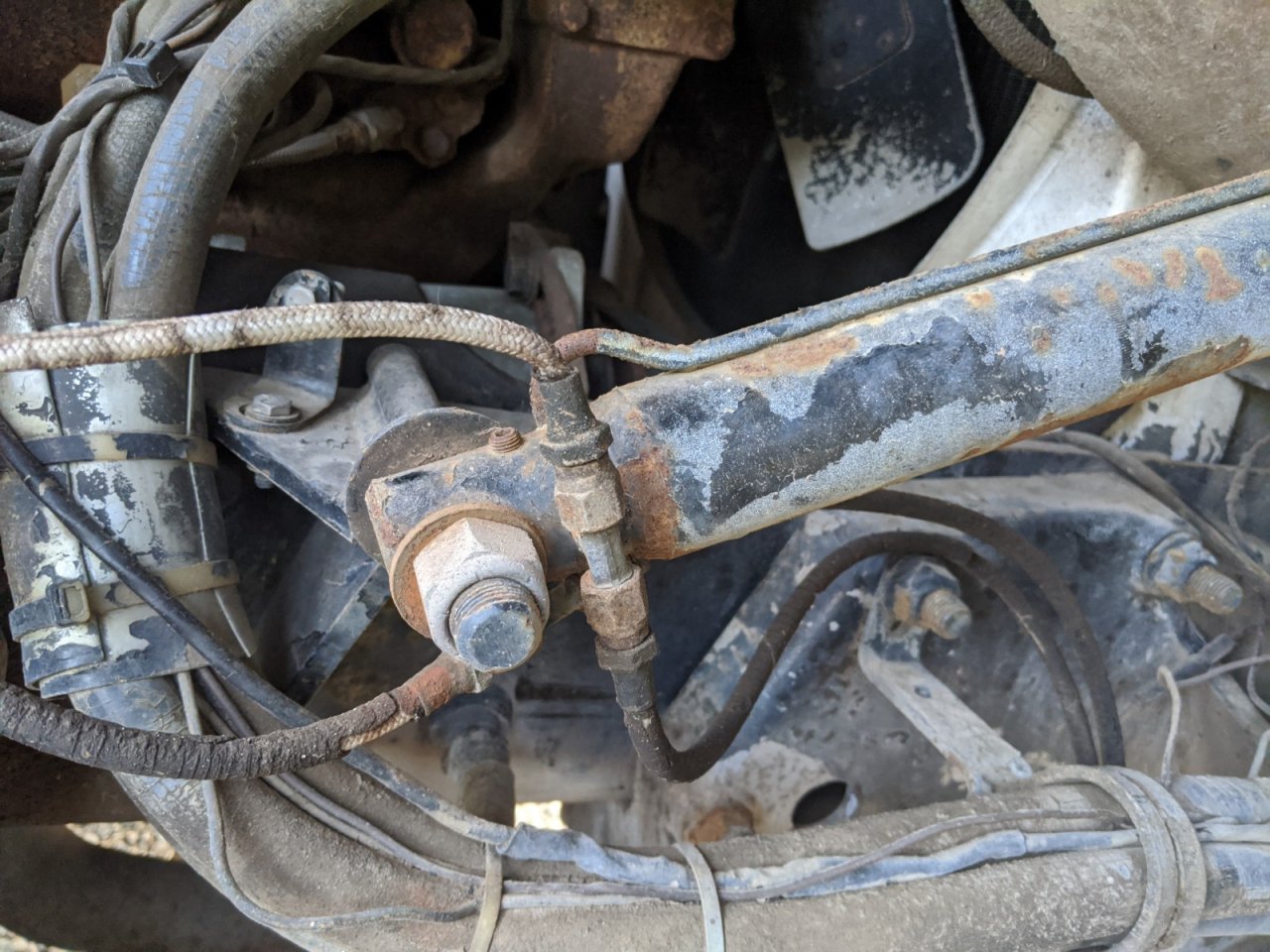

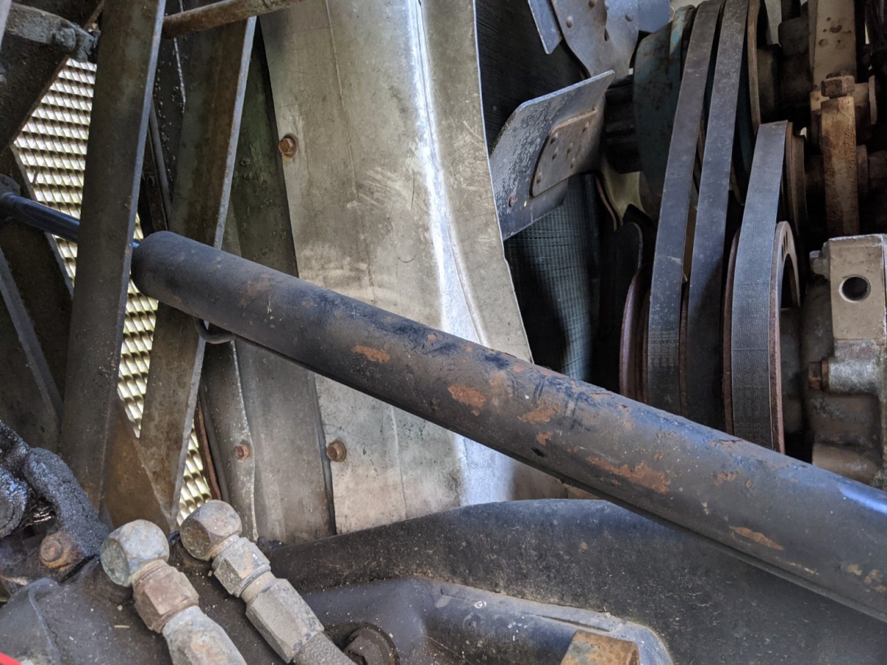

    I looked yesterday and I could not find any part numbers anywhere on them. Here are some pictures for reference.

    Are you sure its not the pump, those cil. look bone dry?

    Yea I have a brand new pump and cylinders now just gotta install
