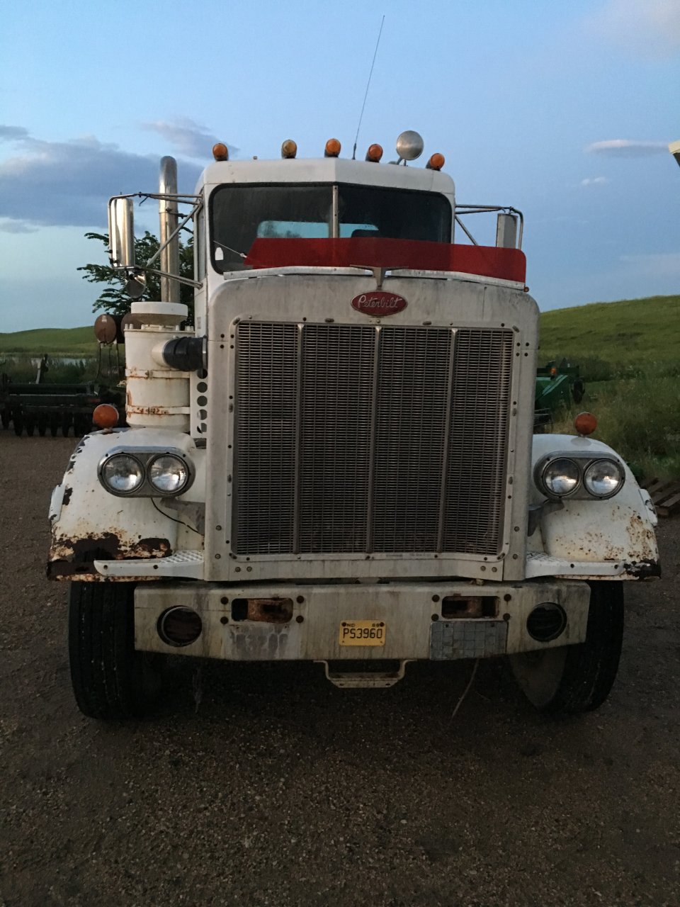

    Like I said I just bought this truck and want to redo it and try to make it all original as much as I can.

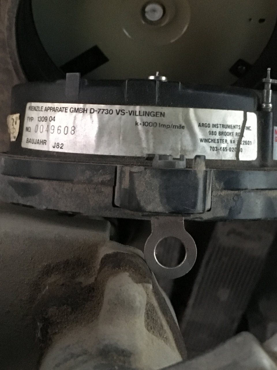

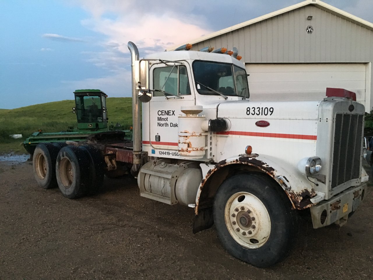

    Here is a few more pictures of the gauge and the truck.[​IMG]

    Thanks but I don’t need the charts. Just looking we’re I can get it fixed.

    I had an 83, and the speedo and tach drive were both cable driven. It was an easy and inexpensive fix to change the cable. The back of the speedo had a square drive hub that the end of the cable fit into. The end of the cable had a pressed on square drive piece about an inch long that fit into the socket on the back of the speedo.
    You might check to see that the cab le turns while moving. When they get bad the gauge will start to jump a lot until either the cable brakes or the drive head is worn out to the point the drive spins inside.
    x1Heavy Thanks this.

    That's what I'm thinking, you need a specialized shop that repairs gauges. Probably a few of them on Google. I bet it will be a mail-it-in type of deal, not a place that's likely in your town. Probably has nothing to do with trucking either.
    Here's one:
    http://dandmrestoration.com/services/clusters/
    First hit on Google
