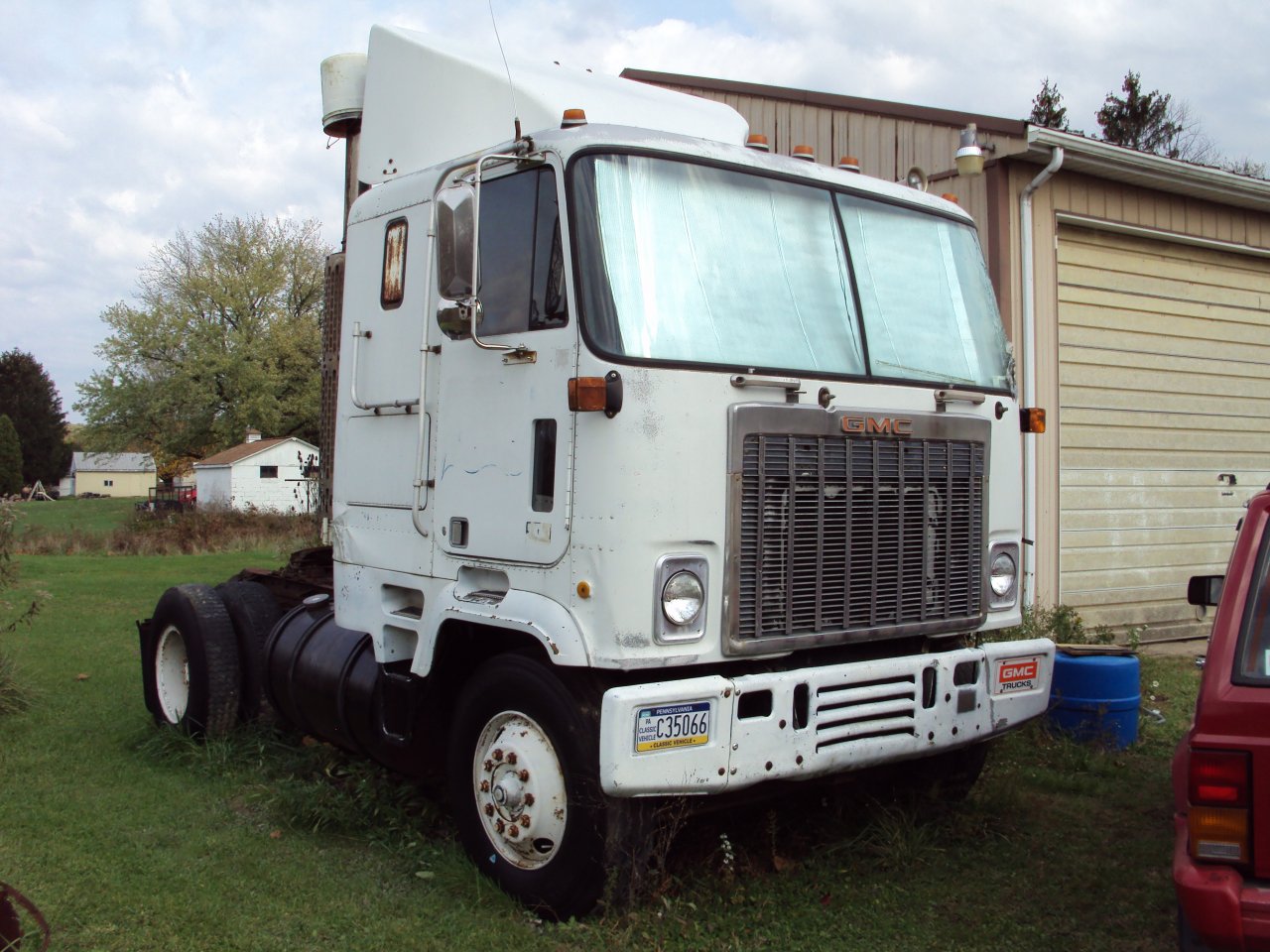

    Cleaned the truck up a little today and bolted on the new pump.
