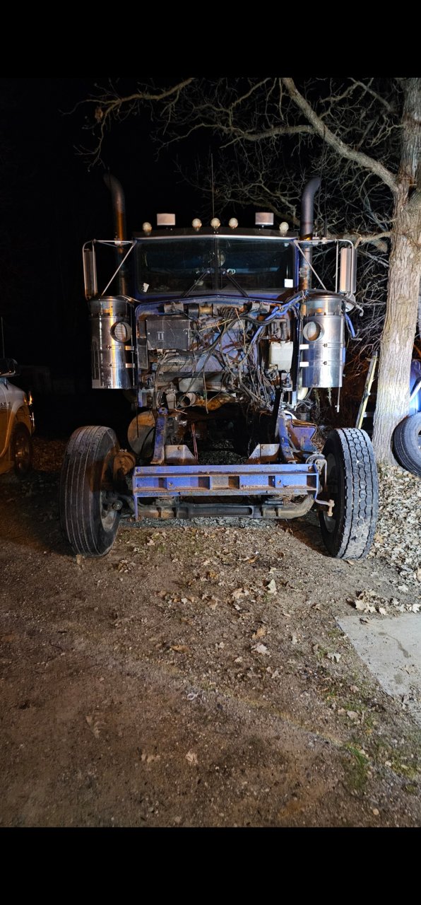

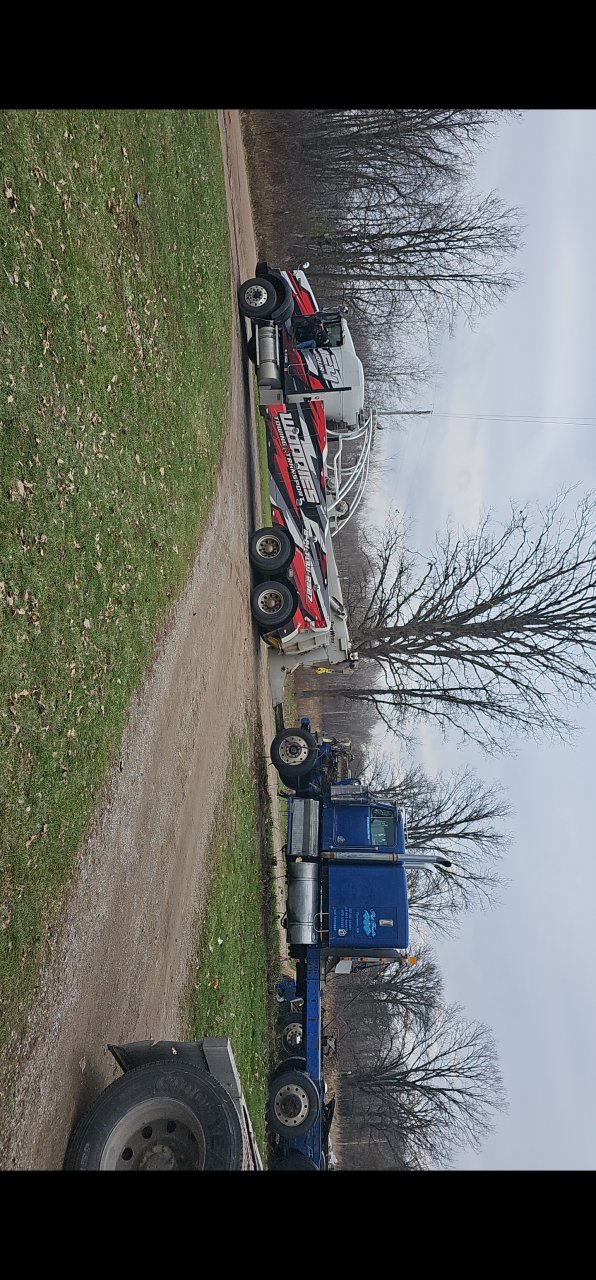

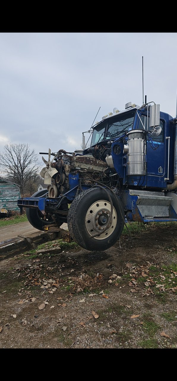

    Pictures of the first time last November Woodies towing came out and gave me a hand. Really good guys. Pulled it over to my house. Pulled the big cam engine out and sat on my driveway heartless couple weeks Screenshot_20240409_211859_Gallery.jpg Screenshot_20240409_211916_Gallery.jpg Screenshot_20240409_211852_Gallery.jpg Screenshot_20240409_211839_Gallery.jpg Screenshot_20240409_211834_Gallery.jpg Screenshot_20240409_211815_Gallery.jpg

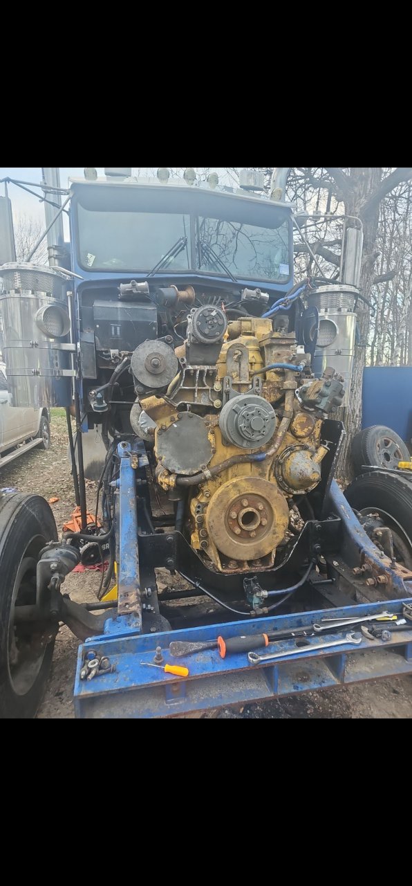

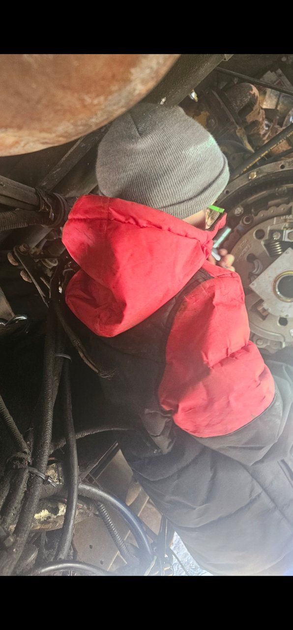

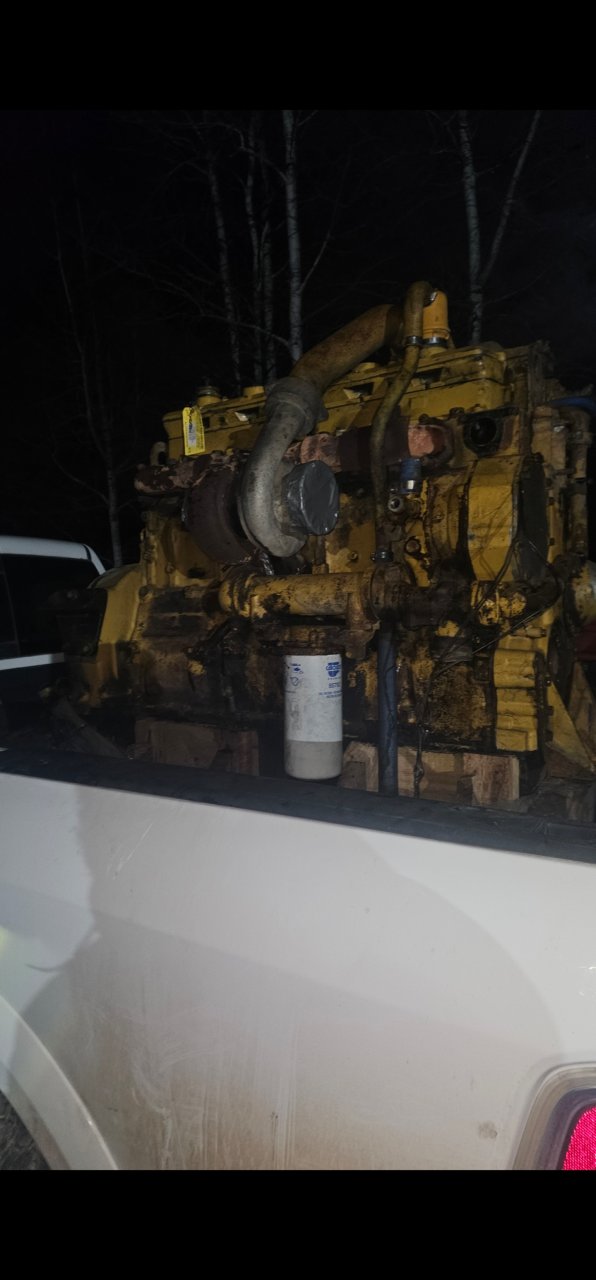

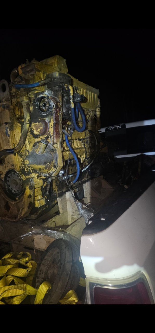

    These are from few weeks later. Thank God for Minnesota mild winter this year. Kiddos cleaned and degreased the engine bay. Lot of oil and grease. Just looks wrong without a hood and engine. Brought the old tranny in for a core and Picked up my 3406b i bought in my ram. Was top heavy ride home. Wife got the flywheel resurfaced. It's the 15.5 inch new style not the ole style hard to find clutches. Got most of the air bags removed and put new ones in with new mounts. Still have the back two to do.

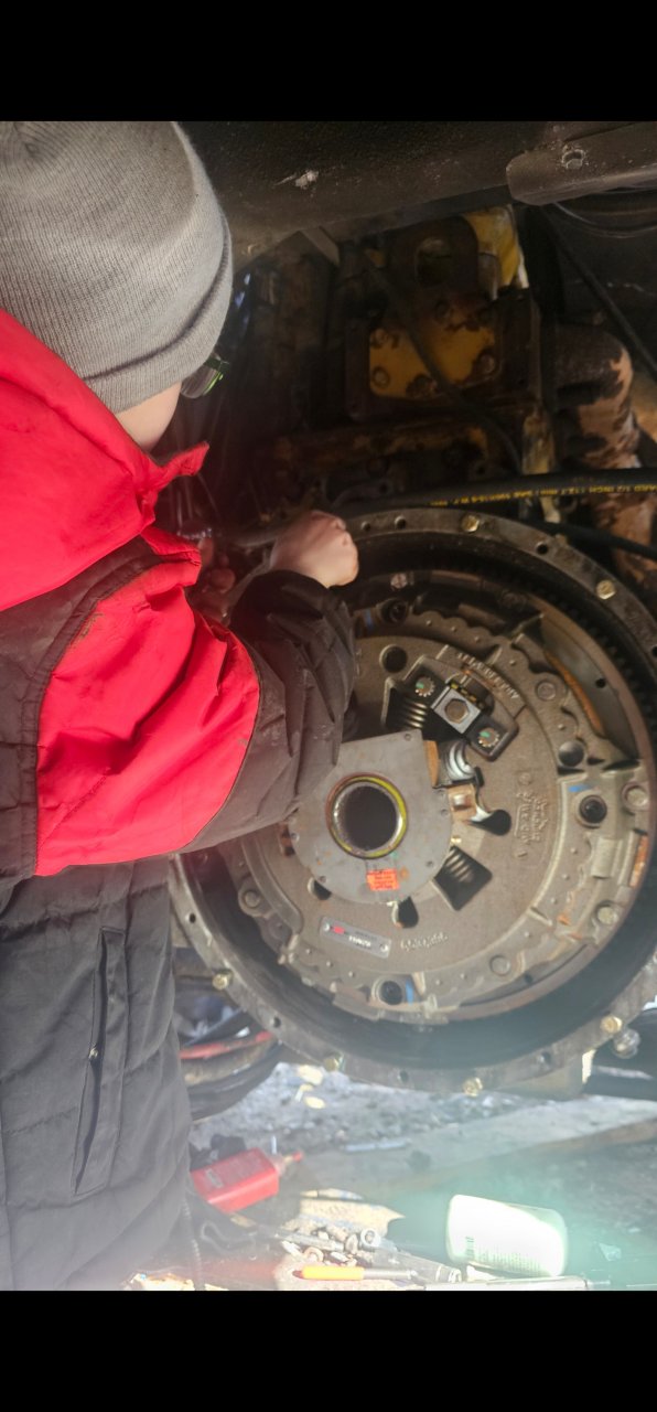

    Took help of my boy a few of my moms kids we got the tranny in. Had to pull it out. Redid the bad helicoils that my idiot self didn't check... someone previously did a bad job on it. I fixed it properly. More tools more parts... went and actually got threaded inserts as ultimately they fudged the hole bad.. taught william how to run a tap and how to install inserts. Hopefully good memories for him. We tightened up the engine mount bolts to. Next stage was to start doing heavy lifting after scraping the engine down to high temp primer and paint and high temp clear coats
