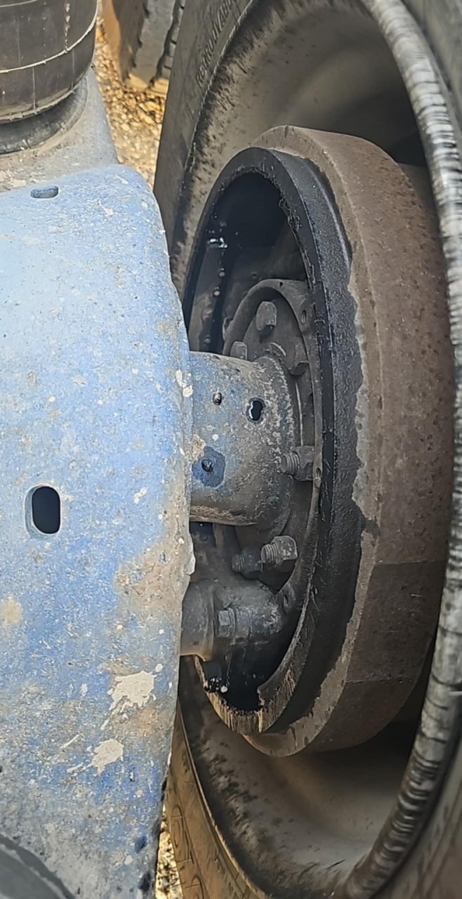

    Had the fun experience of learning to change wheel seal before being loaded. Learned from going out west you carry parts and tools to do about anything. But from that issue it's the last pig load up there I guess. Which is fn dumb but that's trucking. Pto being installed next week.
    Thanks for the transmission pictures and the advice. I look at my bag height this weekend and look at the angle of my 4 driveshafts as well.

    Make sure the rear end vents aren't plugged up after sitting for so long or you'll be doing it again.
