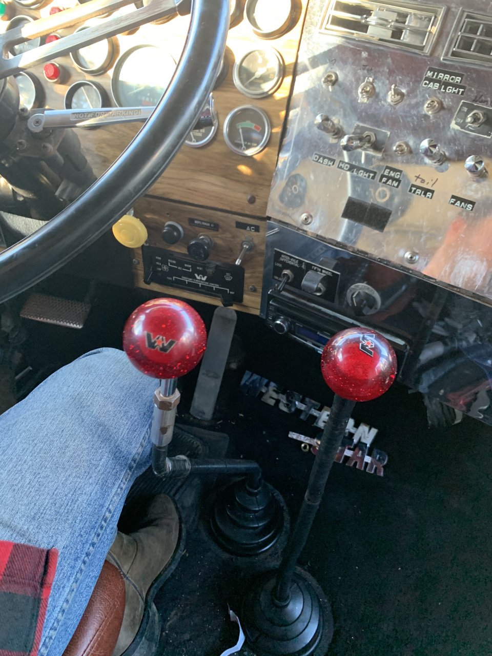

    Put some new shifter knobs in. Dropping off to have motor done in a couple weeks. Then off to a friends to button up all the little odds and ends. Then tires, then hauling freight. Torn on what to do with the neway as bushings are junk and parts are obsolete. Found parts in Canadian, don’t want to spend the coin then they show up and don’t work.
