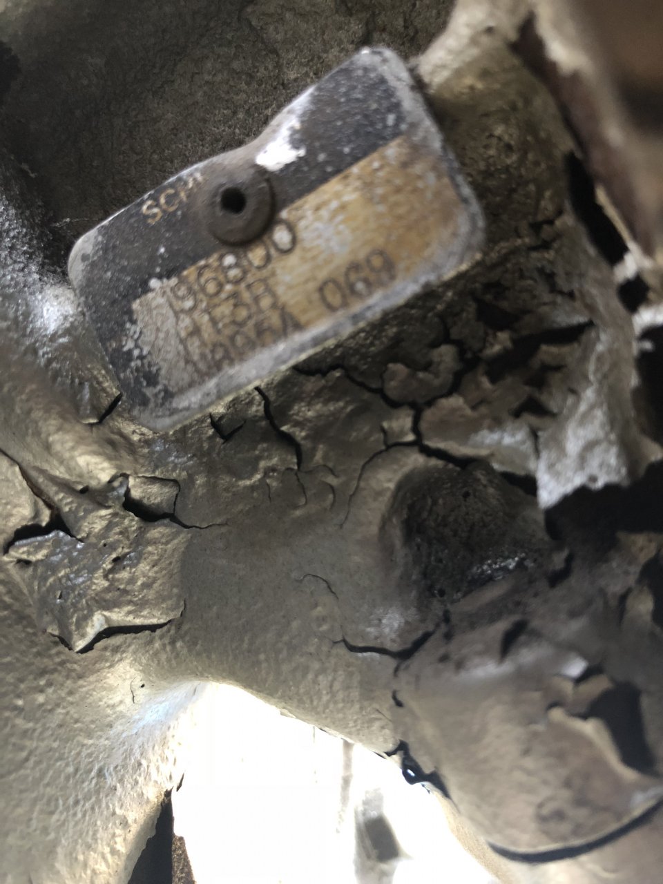

    The most common one for that engine is the HT3B. Holset or Schwitzer (now Borgwarner) part # 196800.

    The 196800 was the go to for the replacement for 290’s up to the 444’s for many years and is still available. So it couldn’t hurt anything and he shouldn’t go wrong with it. Works better with a dual outlet pulse manifold but it is not required. I have noticed that it will even show a little manifold psi sometimes with the Jakes on. 7 psi at most.
    The one I have on my sc 350 came off a bc 290 that was built to a 400. Probably a million on it and still blowing. Lol!

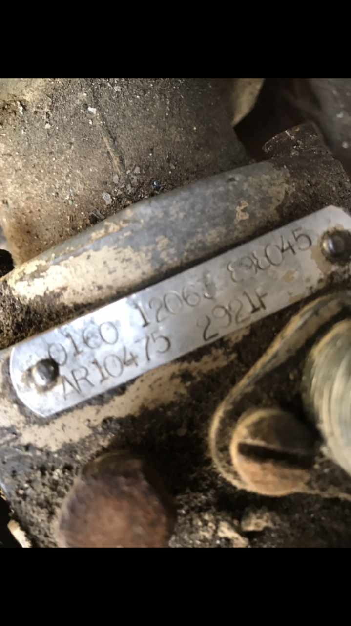

    Well I tried to look when daylight came for the pump code and unfortunately someone painted over it and doesn't look like it was stamped on i took a couple of pictures I will post

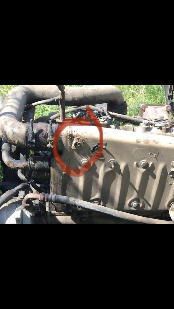

    I also want to add a boost gauge since the truck doesn't have one where is the best place to put it?

    Give me a few hrs. To get into one of my storage trailers. I’ve got a formula 350 with that same after cooler on it. Let me look and see if it had a gauge in the truck it came out of and where it was plumbed in if it did.

  11. OLDSKOOLERnWV
    18,527
    279,816
    Been a long time so I can’t remember either lol, but thinking it’s here...? 76C6074C-0A4B-4184-BB41-15089E324A5C.jpeg
