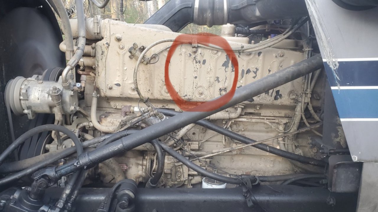

    As @Dino soar mentioned, usually a Cummins reman engine will have a tag on it. Usually it is found on the aftercooler and will say “Cummins Recon”.
    The serial number on the block will tell the tail if it truly is a Recon, Cummins will have info on its rebuild.
    And the pictures you shared of your engine @n4ane tells me it is still low flow cooling.
    But as we discussed earlier, if the block serial number, and the pump code number match, then most likely we have a dead ringer, UNLESS someone has been into it....
    My engine is built to CPL 625, but I have oversized injectors in it, as well as a bigger pump and a different turbo..... so we are simply trying to help determine exactly what you have...
    Dino soar Thanks this.
  6. OLDSKOOLERnWV
    19,201
    290,467
    Usually the “Recon” badge will be found in this area.....

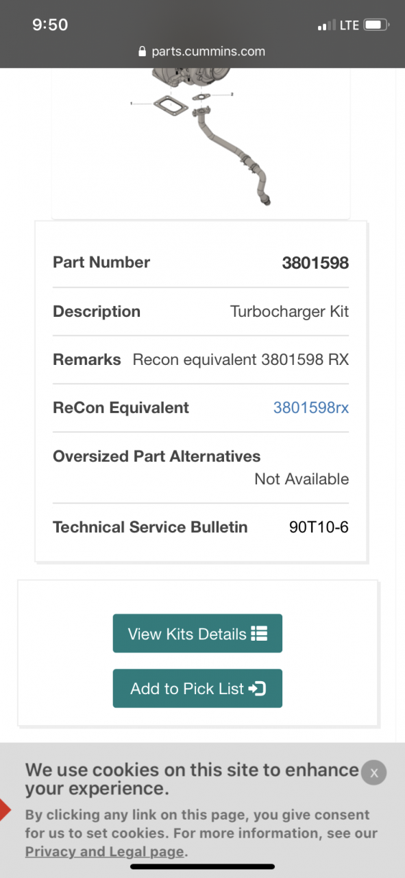

  7. 062
    062 Road Train Member
    6,347
    34,012
    Oct 20, 2013
    You posted a pic of the part number. If you want to go back with what you have now. B4F30A79-3B2B-47E2-8CF3-3ECF8DFEBD34.png

  9. n4ane
    n4ane Light Load Member
    132
    59
    Aug 28, 2020
    How did you get to that? I did find a part number that I put into Google and found one so I ordered it and FedEx delivered it today 20201122_183609.jpg 20201122_183555.jpg 20201119_183402.jpg
  10. n4ane
    132
    59
    Aug 28, 2020
    So I used that web site and looked at it and something has been changed on the truck. The intake is different. I was hoping to use that to be able to get the correct part numbers for all gaskets and seals to change the turbo and gaskets on the manifold due to one of the leaking. I guess the gaskets will be ok but the bolts wont be.
