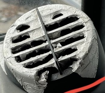

    I wonder why someone duct the duct??

    Controls probably stuck on heat in July and he needed some relief...

    The one on the right says “normal operation” I’d guess like others, power divider. Though it might be a front brake 50% valve, used for bobtailing. Left ones missing the safety cover. Might be an air suspension dump switch. Might be an air ride “soft” setting switch for bobtailing.

    Not sure was like that when I bought the truck

    Ahh sorry it was early...One on left I’m pretty sure is your power divider Right one either front axle brake cut off or fifth wheel slide
    Try em and Ck
    Also ck Paccar with VIN they might be able to provide original build sheet Might

    I suspect one of them may have been for limiting the front axle brakes, which would be the "slippery" switch, and the other the power divider. I don't recall any trucks of that era having lockers. One should be the power divider for sure. I guess it depends on whether or not it had a sliding fifth wheel, in which case that would be the other option as many have mentioned.
    Two speed rears would be the only other option that comes to mind.
    Edit to add: The first truck that I drove was a 70 Pete, and it had a switch like that for the parking brake, but it was on the dash. A 90 model would not have had that.
