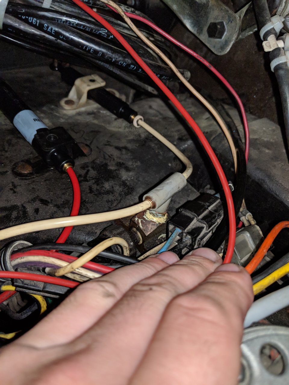

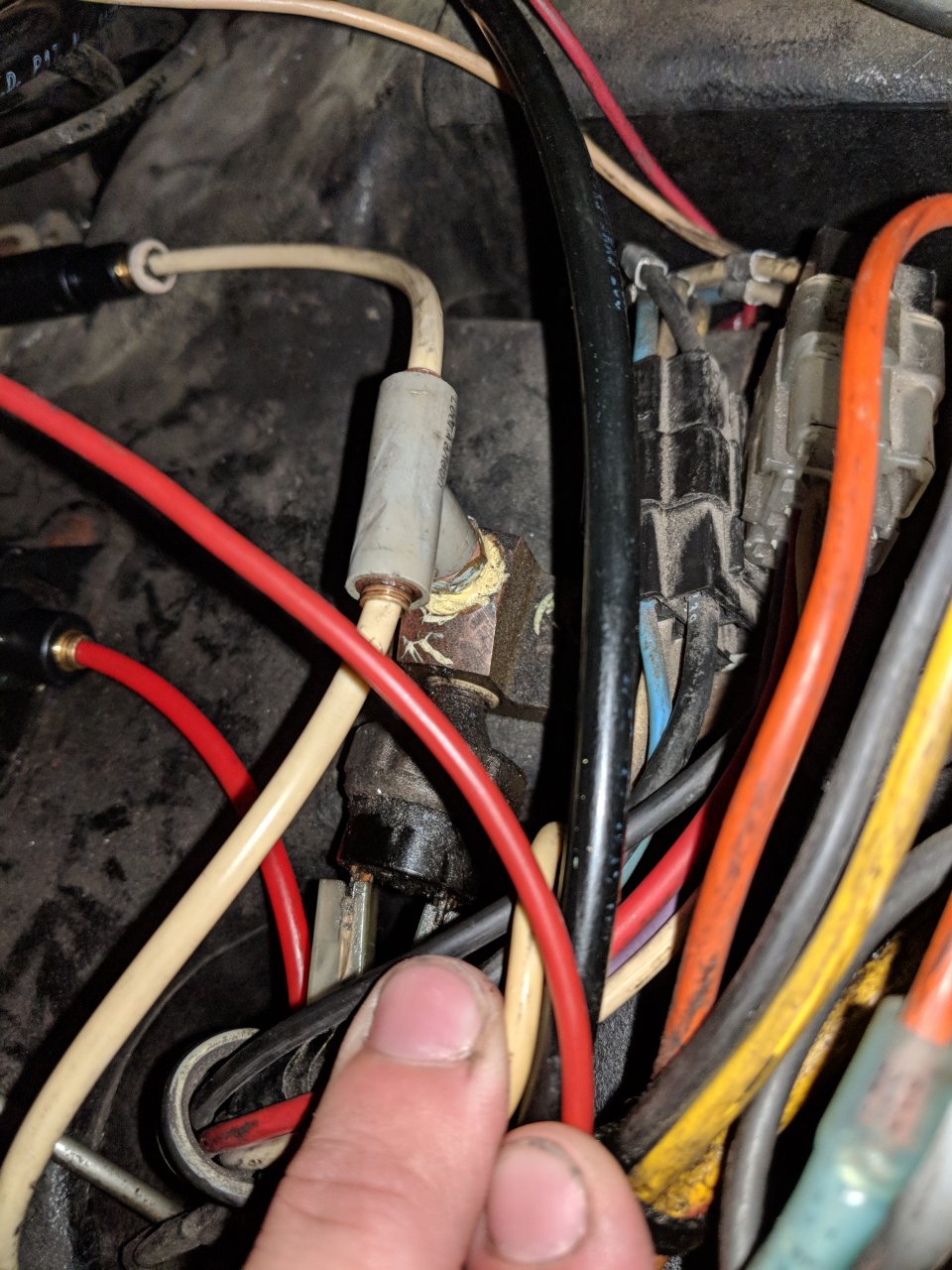

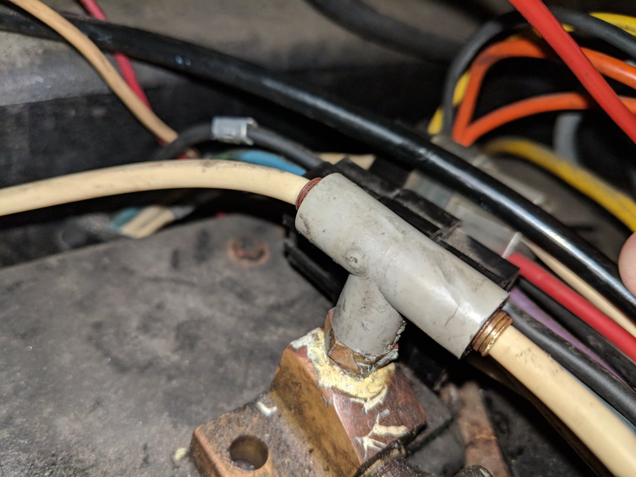

    The"assembly" your fingers are pointing at isn't really an assembly at all -- just a plastic quick-connect tee screwed into a brass 90-degree elbow, with the low air warning switch screwed into it. The switches are available from Kenworth with a 70 psi set point -- they're standard 1/4" air switches. After I bought my 1994 Pete 377 I had to buy 2 of them. Mine were in a common aluminum air manifold on the floor behind the clutch pedal.
    Reason for edit: Added pictures to illustrate
