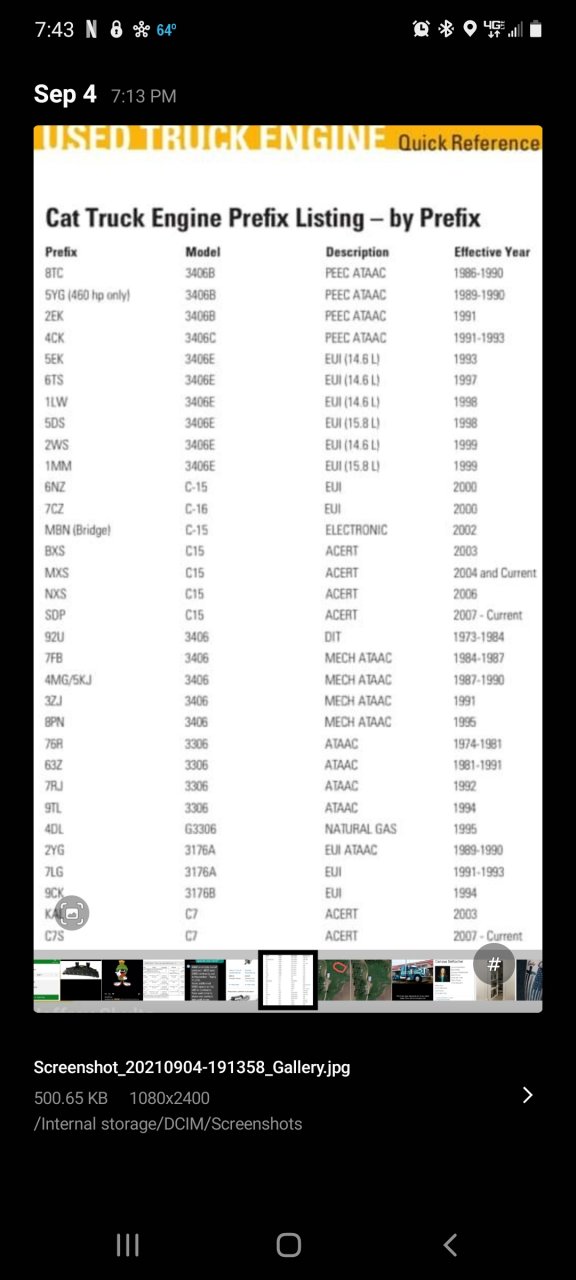

    Screenshot_20211011-194332_Gallery.jpg would think it would be a 5ek but I dunno. Peec had its issues but easy to make full mechanical I think. A picture of engine would tell the tale easily

    I have sign this before, and used it to tell these guys who have a 6NZ made in 99 that they are not eligible exempt. Then one sent me the ecm printout, and it showed that his 6NZ was a 99 model year. I test drove a 1995 W900L with a C. I'm sorry, based on those 2 exceptions, I don't believe this list anymore.

    I found it on the internet so it has to be true right?

    Could be an 8PN. That looks like a 1995 engine.

    More of a guideline than a rule
