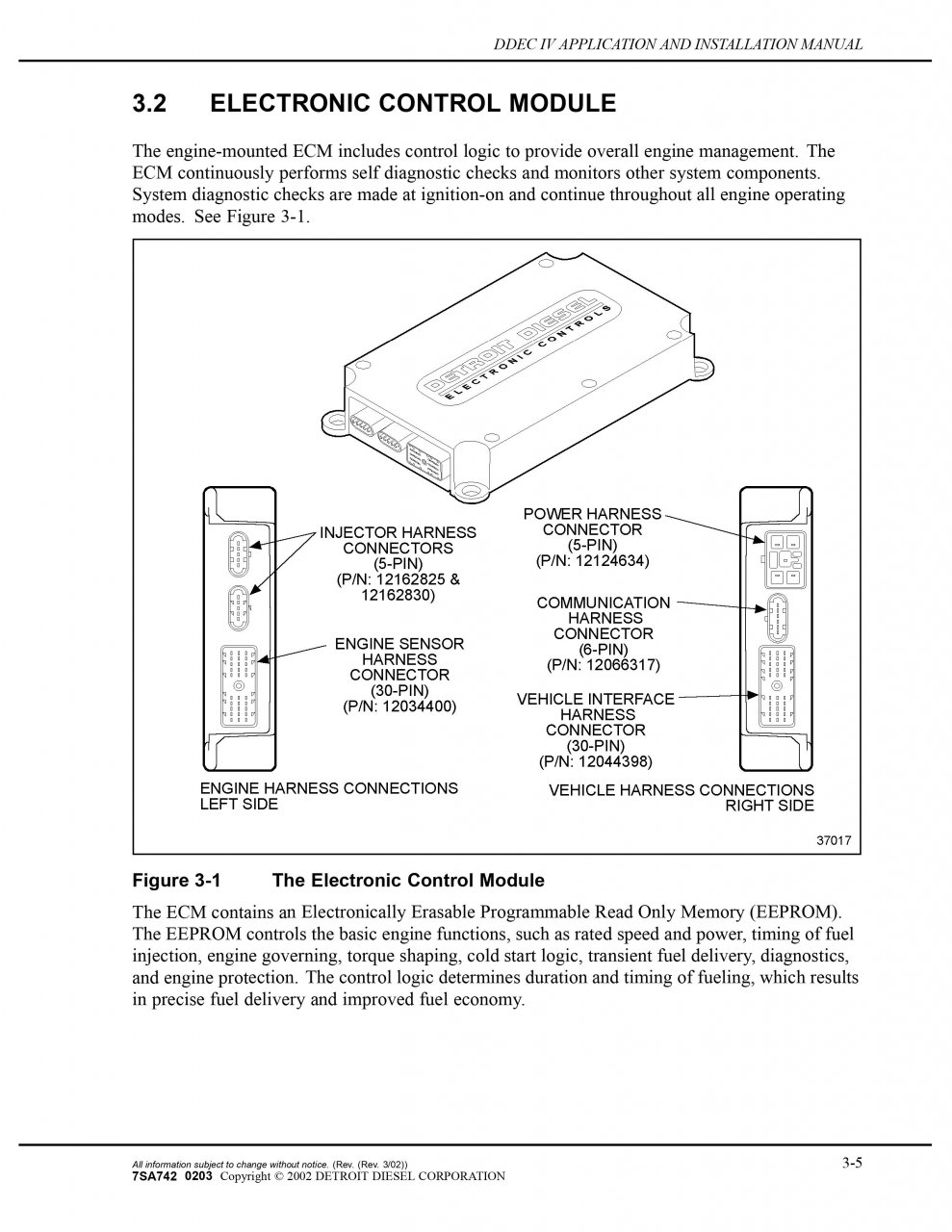

    Engine to ECM.jpg CH3_DDECIV.PDF - DDEC IV APPLICATION AND INSTALLATION MANUAL Chapter 3.jpg Vehicle To ECM.jpg
    These pics are for DDEC 3-4. P3/133 on the Engine Sensor Harness connector is the location for the coolant temperature sensor. If somehow the coolant level sensor is the cause (as some previous post supposed), it's location is H3/115 on the Vehicle Interface Harness Connector.
