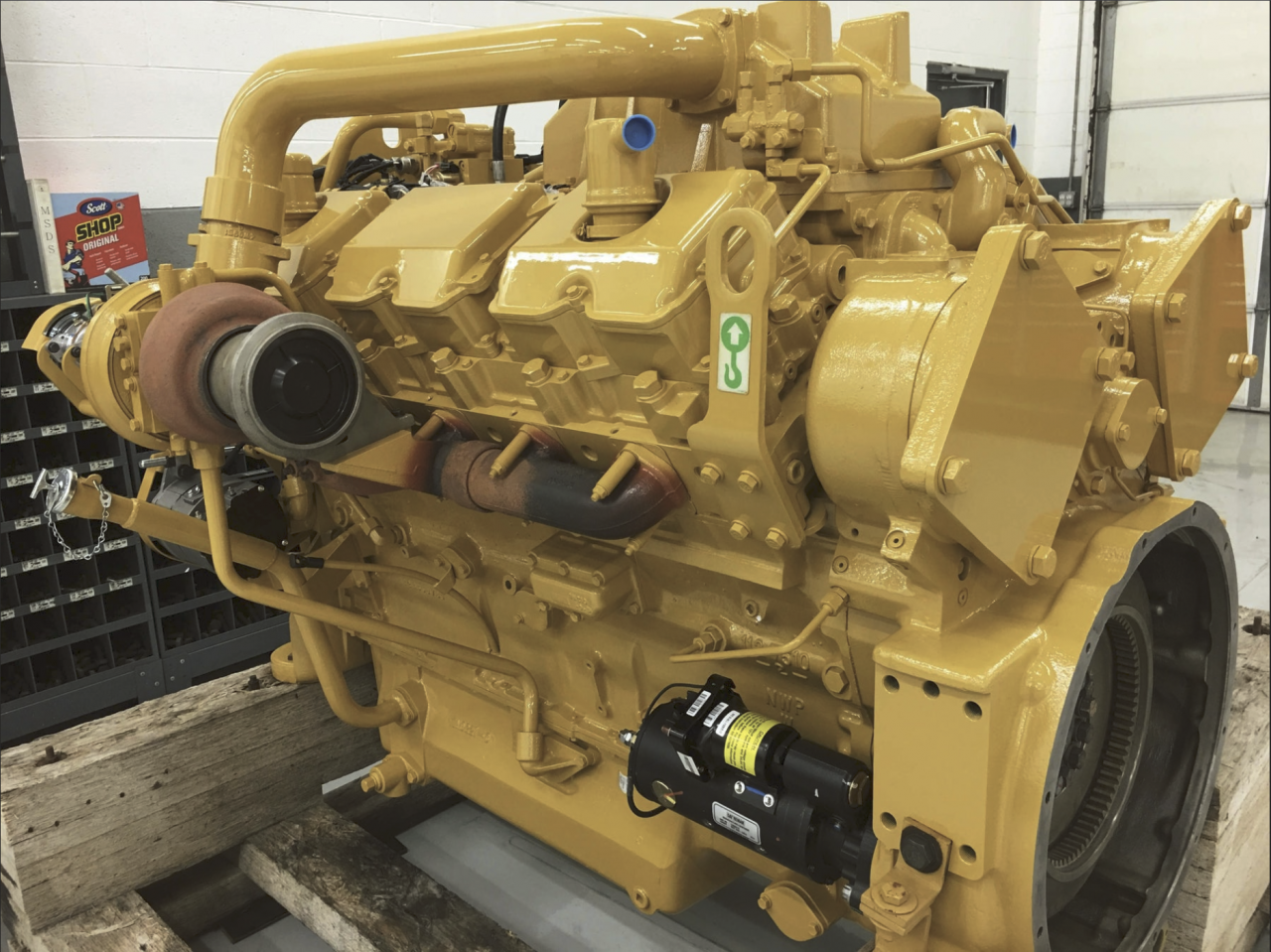

    How about a Twin Turbo 3412?
    She will pass anything but a fuel stop!
    Diesel Dave, RockinChair and W923 Thank this.

  11. RenegadeTrucker
    RenegadeTrucker Road Train Member
    2,780
    2,496
    Dec 25, 2009
    Montana
    It is a pic I grabbed off the internet, if I had one I'd be shoe horning it into an ole A model!
