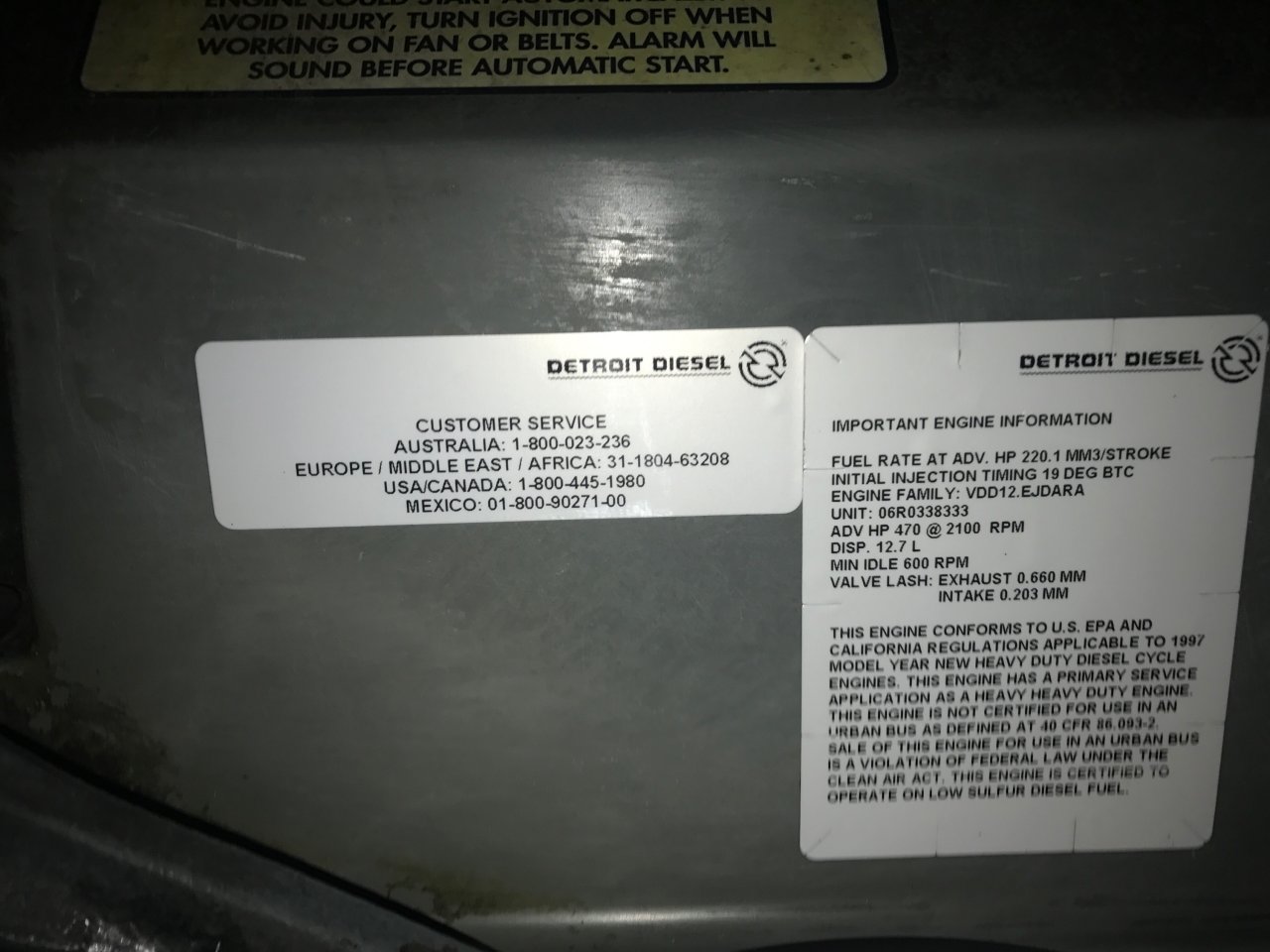

    There is a truck that I’m looking to get. The truck is built in 2000 but it has an engine model year 1997. It will be exempt from E log?
  7. kemosabi49
    10,995
    48,000
    Jan 13, 2013
    SW Arkansas
    Probably yes. Tag on engine meay show build date. But if the motor has been factory rebuilt since the end of 1999 probably not. It should have a tag showing the rebulid date.
  8. Studebaker Hawk
    Studebaker Hawk Road Train Member
    3,021
    9,859
    Oct 18, 2010
    NW Indiana
    It is not the date of the rebuild. It is the EPA model year specification it was built to. The truck you see on the left has a factory remanufactured engine installed by Detroit Diesel identical to the OEM engine, which was an EPA 1999 model year engine. It was installed in 2008 and the truck is exempt from mandatory ELD requirements.
    Just like a 2018 glider with an engine remanned in 2017, if built to the 1999(or earlier) EPA model year specification is also exempt.
    Vio Thanks this.
  9. Vio
    Vio Light Load Member
    150
    67
    Sep 25, 2012
    AZ
  10. Studebaker Hawk
    3,021
    9,859
    Oct 18, 2010
    NW Indiana
    You are good to go. Enjoy it.
