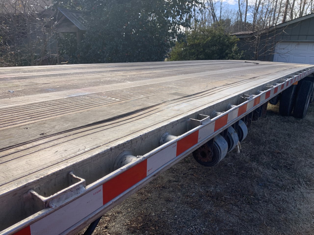

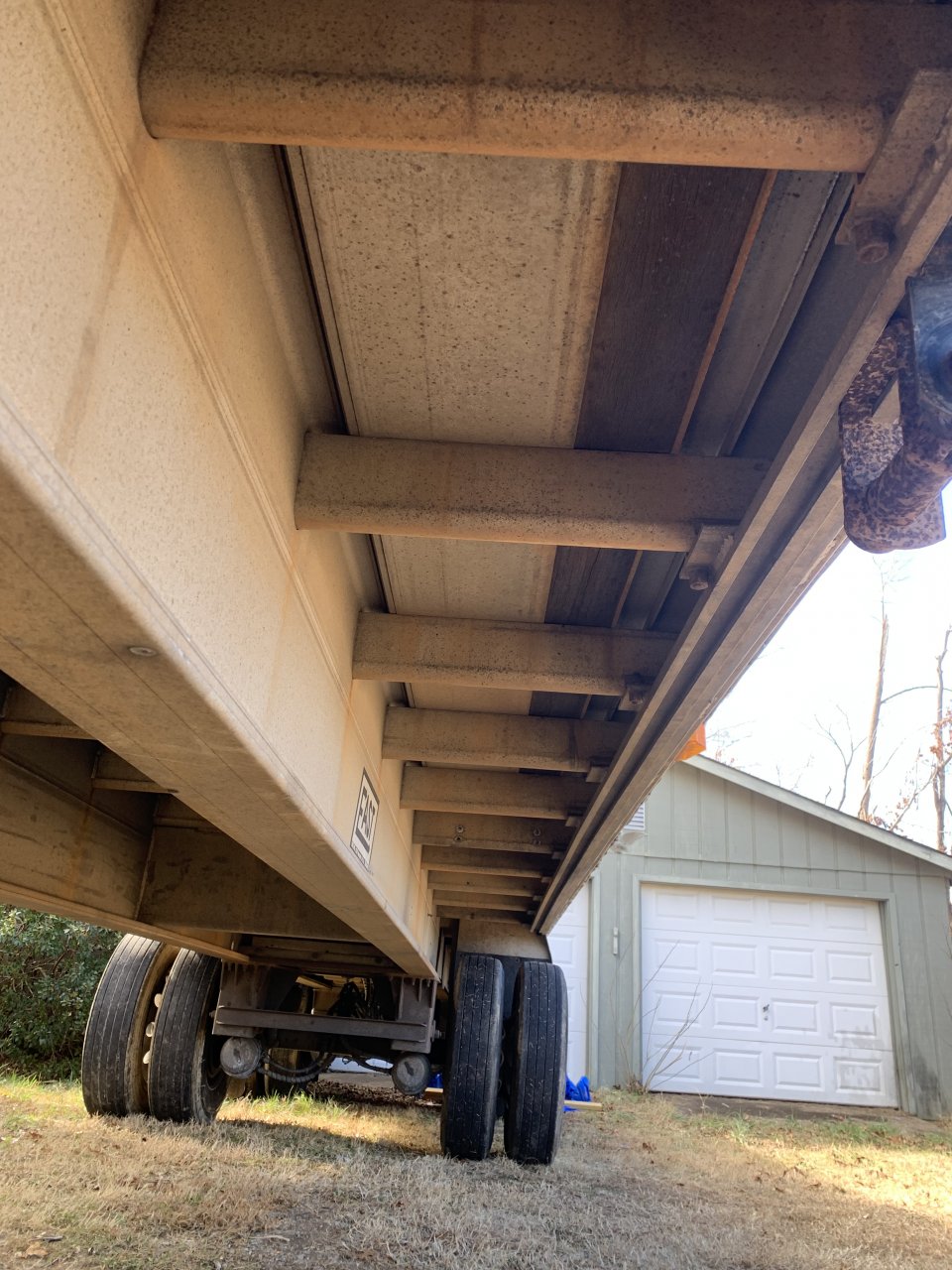

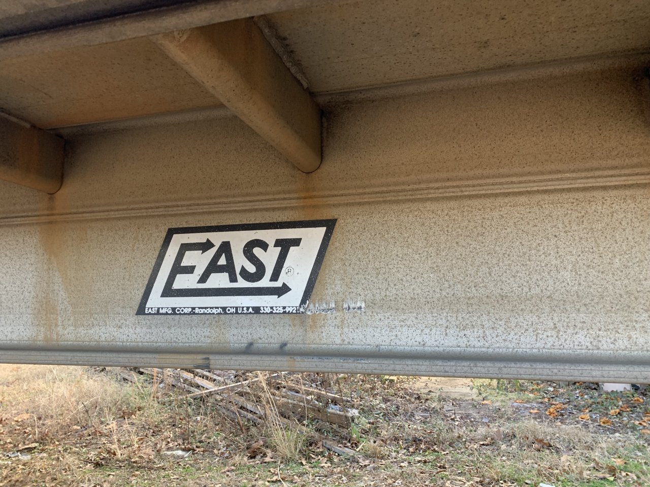

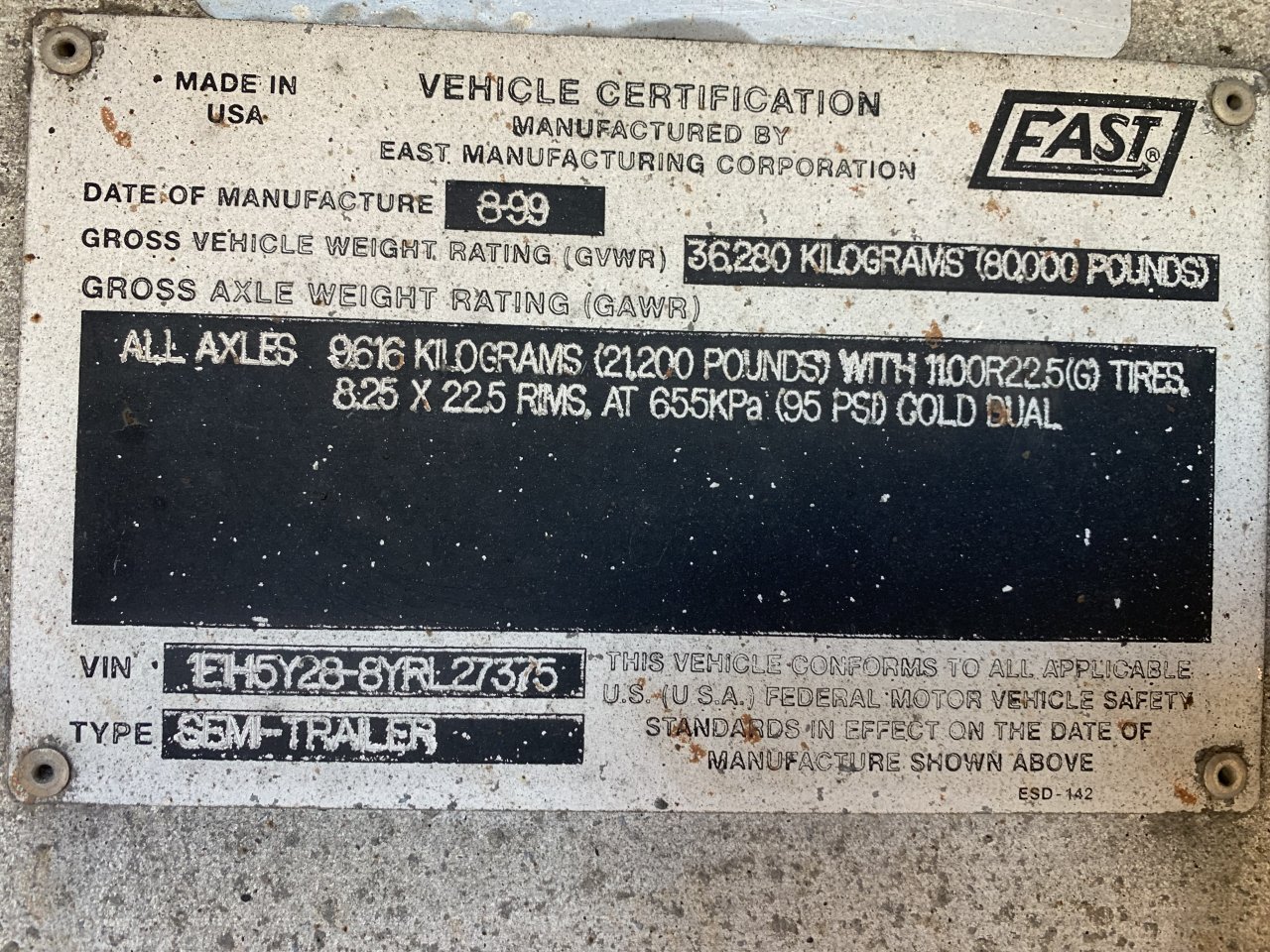

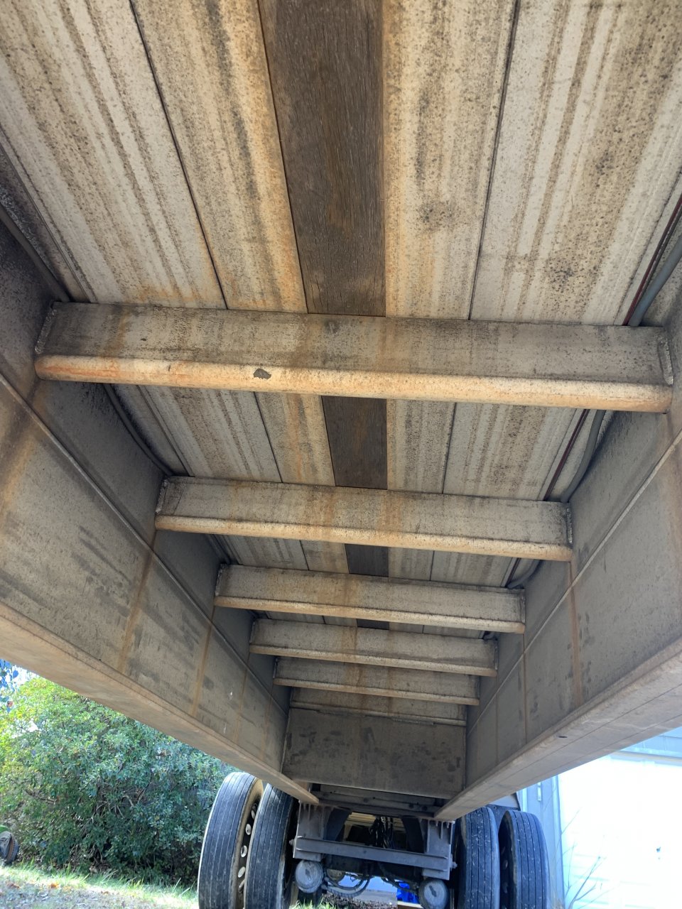

    Well I went and looked at this one today he said he hauled coil and steel with it as well as other freight but don’t really see extra braces up there, the deck was solid and wood had been replaced recently . The outer edges had what looked like a wave going he said he bought it like that 3 years ago any feed back on this one I really like it and the price is pretty good 6k I believed for the condition
    it’s a 2000 east aluminum 80,000 gvwr would need tires, all the brakes and lines/ s cams, bushings, bags have been replaced recently he swapped them out for his new trailer he bought IMG_4509.jpeg IMG_4510.jpeg IMG_4511.jpeg IMG_4514.jpeg IMG_4513.jpeg

    Did you measure spacing on crossmembers? Looks 16" OC. That trailer is for lumber/drywall. Loads that cover the entire trailer. The "Waves" are the floor being crushed between crossmembers. It definitely is not designed to haul isolated loads.

    I remembered you mentioning that and that’s why I was skeptical, he said he’s hauled isolated loads I just thought the “waves” looked off and that’s what threw me off. I let him know I was going to pass, I’m just going to use the trailer the company provides that I’m leasing to that hauls steel and keep saving and get a used one with the appropriate bracing Iv found a few just out of my price range. Wanting to get a used trailer. I found some decent combos that have cool packages in them
