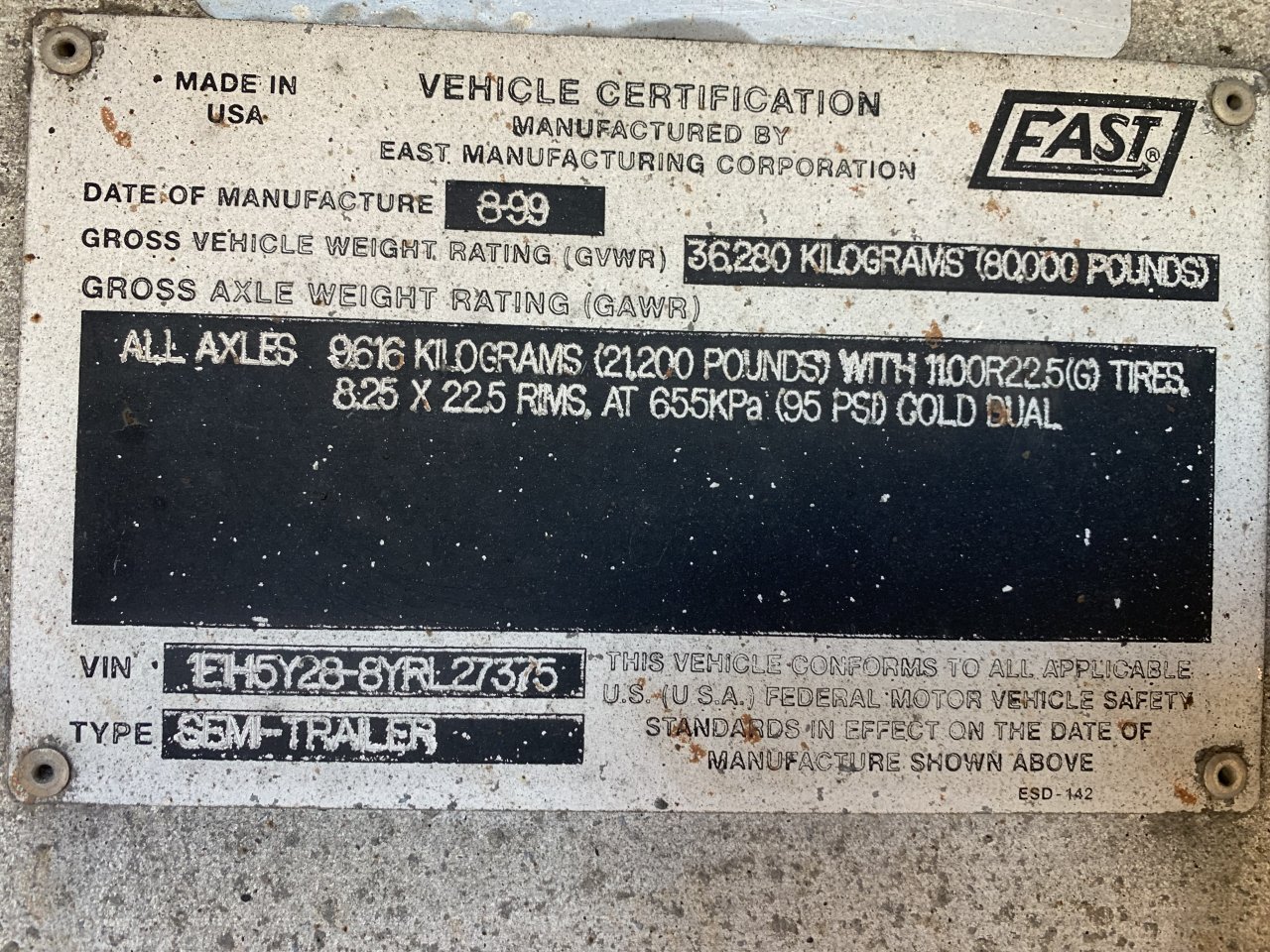

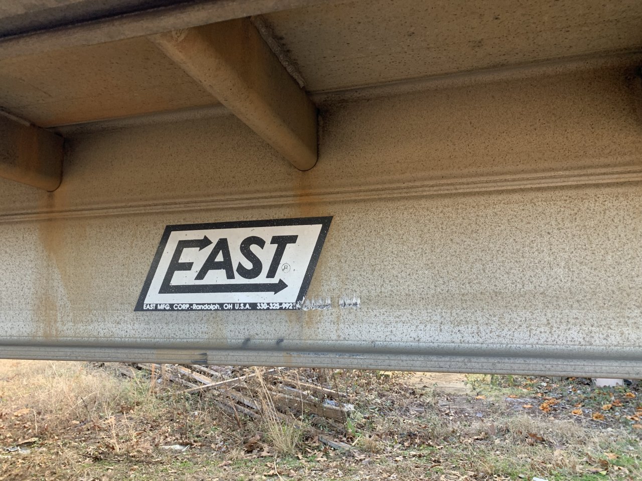

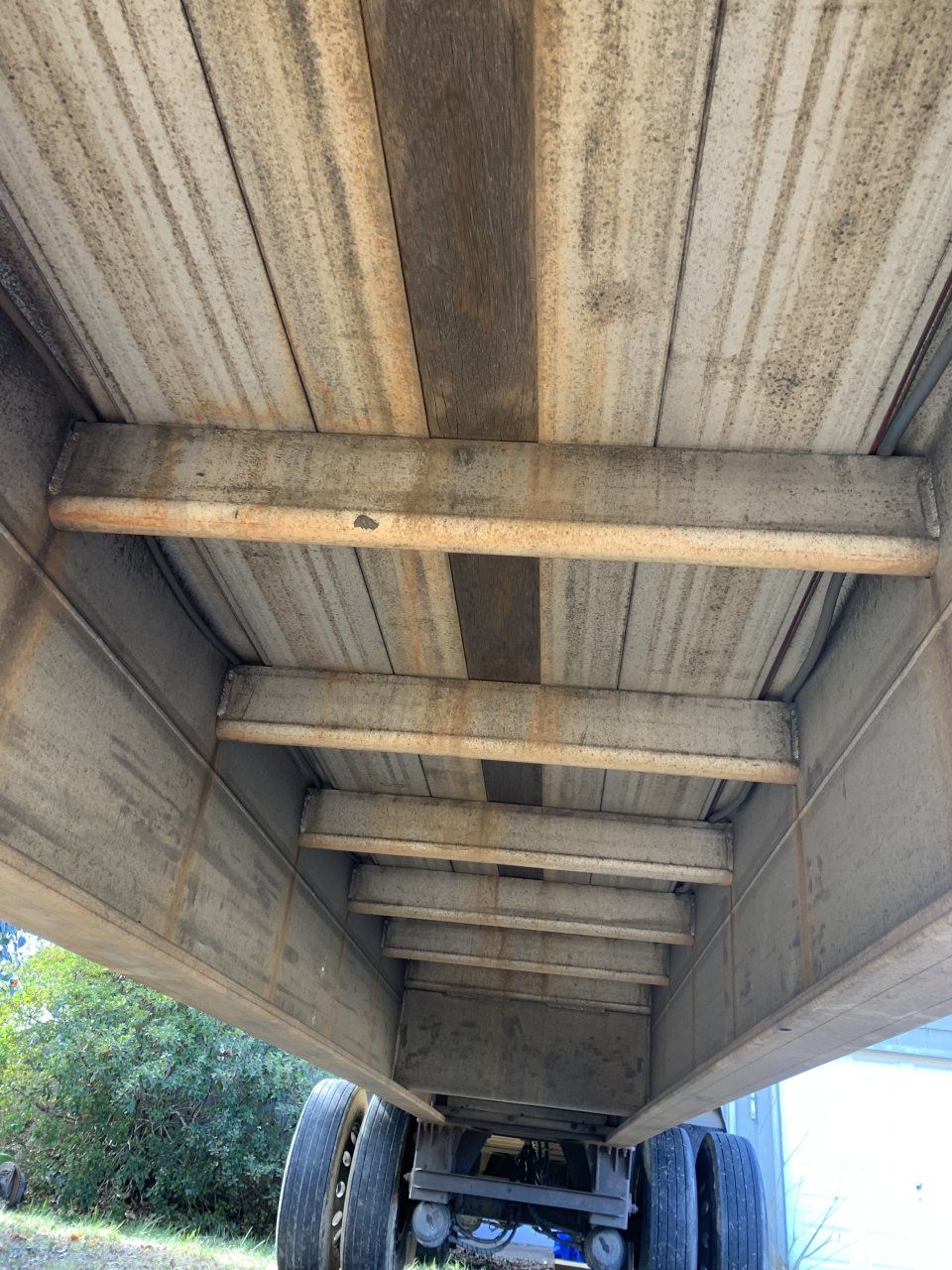

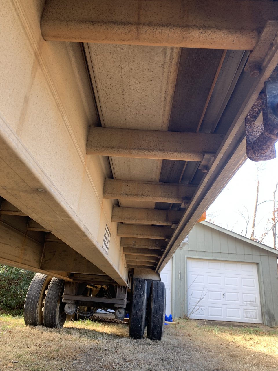

    Well I went and looked at this one today he said he hauled coil and steel with it as well as other freight but don’t really see extra braces up there, the deck was solid and wood had been replaced recently . The outer edges had what looked like a wave going he said he bought it like that 3 years ago any feed back on this one I really like it and the price is pretty good 6k I believed for the condition
    it’s a 2000 east aluminum 80,000 gvwr would need tires, all the brakes and lines/ s cams, bushings,bags have been replaced recently he swapped them tires for his new trailer he bought

    You’re looking at 25 year old trailers. Noone on the internet can tell you more than your own eyes.
    Go look. See if you think the unit in question would hold up.
    I don’t live in steel country.
    I’ve not seen anyone use a 25 year old trailer for anything other than storage or antique truck show combos.
    Is a 2000 chevy pickup a good deal? Pretty tough to know without kicking the tires yourself.

    I would not put a coil on something that old
    Their are places that would not load a trailer that old.
    But it don't look to bad now 8 tires at $450 each
    If ya got to buy rims $80 each
    Shiney wheels $ 200 ea.
    If its 96 wide no thanks...
    Plenty of 25 year old trailers in the oil field that is where they are sent to die.

    Hauling coils on a standard beam trailer beats the hell out of them. Maybe if it had a beefier set of beams I'd trust it more. If you run it be smart and always spead the weight across the deck so you don't stress it as much. I wouldn't haul anything heavy in the belly.
