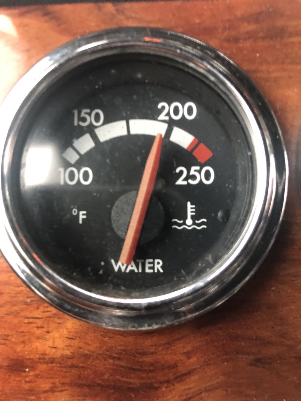

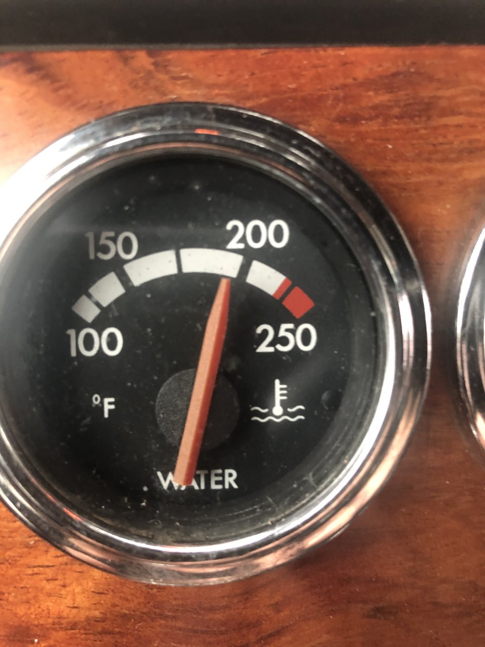

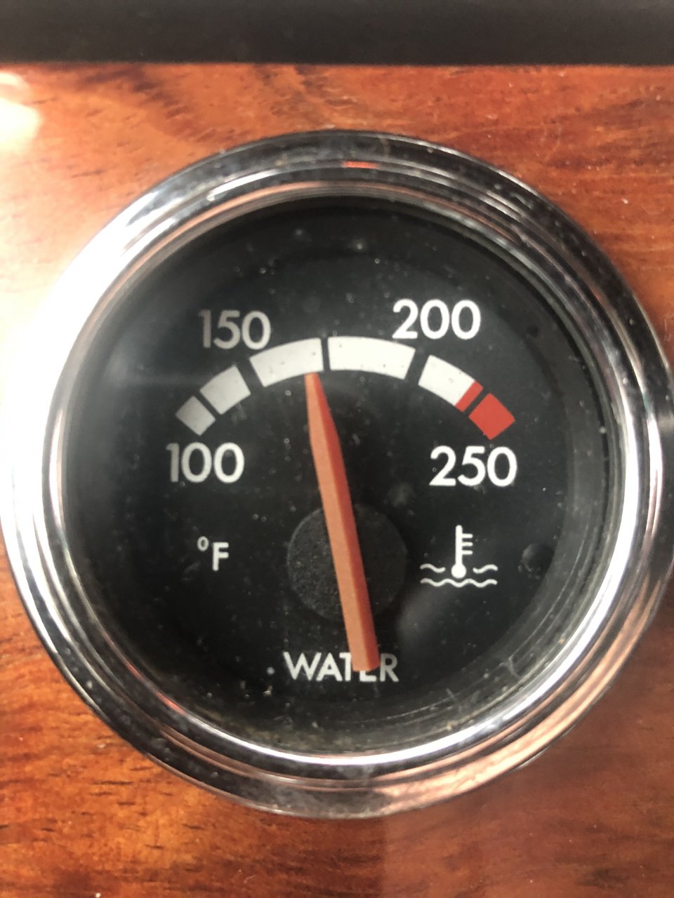

  8. Rideandrepair
    17,572
    56,923
    Aug 8, 2015
    07BE4054-2EDD-40E0-9317-A9B155358D6C.jpeg 1D9D43EB-D54E-4904-AA88-7AB56B0C8A2C.jpeg EDD4B7BE-F7D4-4169-A5FD-4B99300CC906.jpeg Ok, finally got to warm weather. It’s 48 degrees. Idling at 1000 rpm. Fan just came on just about 200, Went down immediately to 190, fan shut off, only tan about 15 seconds. Temp went down a little more, now headed back up. Seems normal. Just running cold in cold weather.At an idle, and even cooler running down the road. Runs cool enough that Cab heat is noticeably less. Last pic is with manual fan switch on, after about one minute. That seems a bit too cool.
